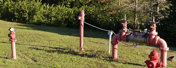

In Florida they require some sort of sprinkler system structure in front of every building. There are two valves in series and they are locked together.
In the example below there is a FDC and another shut off (which I think is for the FDC).
This is not that weird – most places require backflow prevention on NFPA 13 and 13R systems (and some on 13D too). The only reason it looks odd in Florida is that they wind up outside to save costs as you don’t have to worry about them freezing up the way you do in most other parts of the USA.
But why is there two valves?
Because you need to be able to shut off both sides of a backflow preventer to test it properly. All testable backflow prevention assemblies will have valves on both the inlet and the outlet. (This is not far off from the vacuum breaker on a lawn irrigation system, if you have one of those)
