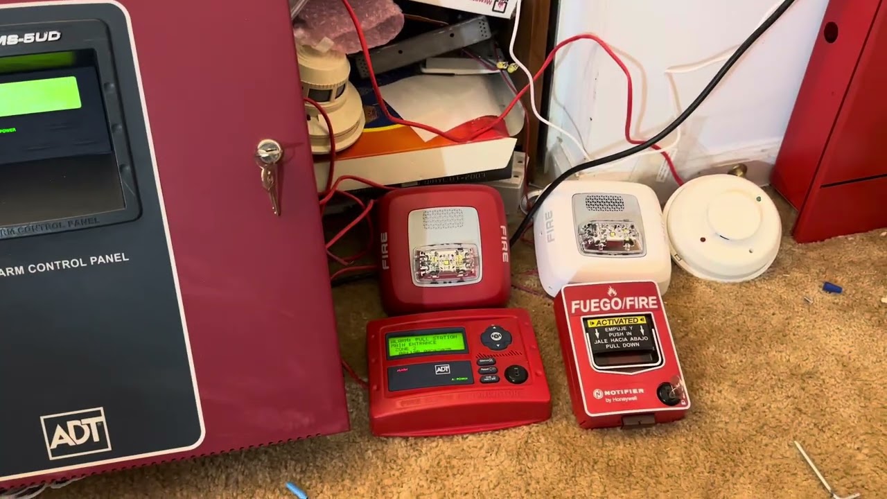

I take it that you have the panel properly set on Gentex Sync but that the Commander 5’s supposed incompatibleness with FWR is causing them to not work right anyway.
