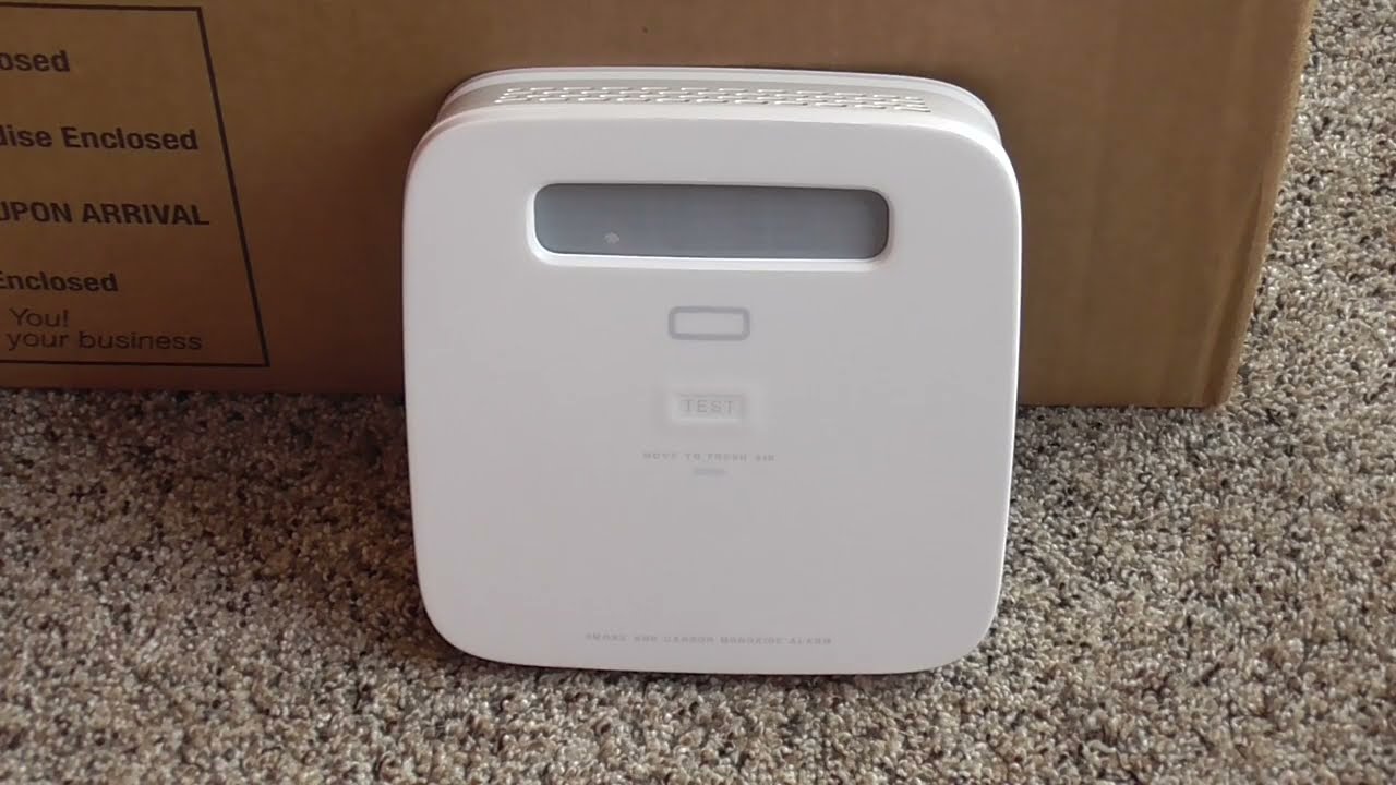

I found a test of the PL1AS:
I’m not sure if the buzzing during the first pulse occurs during every cycle or just the first cycle (or only when the unit is being tested).
