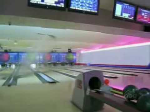

Surprised the alarms didn’t go off. Wouldn’t a flow or pressure switch trigger the alarm after a while? (Maybe it did. I couldn’t tell because of the quality.)
They generally do, but most of them have a slight delay on them to prevent water fluctuations from setting off the alarm prematurely. Most flow switches have a field-selectable retard setting that can be set up to 90 seconds. Pressure switches on alarm check valves may also have a delay, but an alarm check valve will also have a retard chamber on it for this purpose as well.
The misconception about one sprinkler activating setting off the rest isn’t entirely false. @BousaiGuy made a video about fire alarms in Taiwan, and if the water pressure got too low (by an automatic sprinkler or a valve,) other sprinkler jets turn on.

Ehh, what activated is more of a foam fire suppression system. It’s initiated by a single sprinkler head, but the flow from the water (I don’t know if it’s the reduction in static pressure or an increase in flow) causes a valve to open and trip the foam system.
Pressure drop might be the answer.
According to the description, it’s likely that this foam system is controlled by a deluge valve whose control chamber is connected to certain amount of heat-sensitive sprinklers. When the fire breaks out, one of the sprinklers pop, the control chamber loses its pressure, and an diaphragm or clapper inside the deluge valve opens under the pressure difference, allowing fresh water to flow into the foam generator. Then it comes the bubbly downpour!
