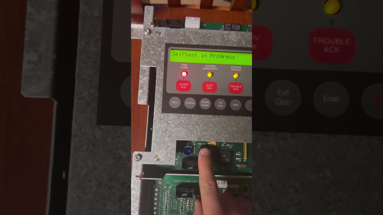

My 4005 is stuck in a continuous boot loop. I need help restoring it back. I am not going to replace the mother board as they are very expensive. I need help

Send a video please, we need more info

I was programming it when I went to save the config it wouldn’t start back up. I’ve tried everything I could
