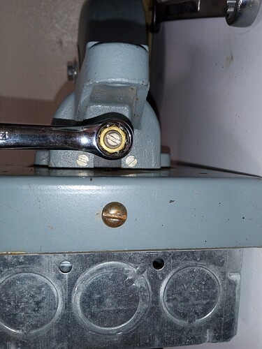

The tools needed are pictured below:
  1. Place the socket end over the 3/8" nut.
  2. Place the large slotted screwdriver blade in the slot to keep the threaded shaft from moving.
  3. Using the box wrench, turn the nut left (counter-clockwise), until it loosens and turns.
  4. Turn the threaded shaft to the left to move the plunger down, away from the gong. (This will cause the bell volume to be lower, and change the sound.
  5. Turn the threaded shaft to the right to move the plunger closer to the gong, which will increase the volume of the ringing bell.
  6. Re-tighten the nut on the threaded shaft after setting the volume level.
  7. Visually check the plunger position, the plunger tip should be visible just under the gong, but not touching it.
