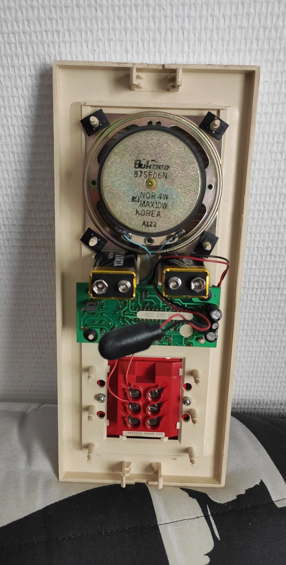

First here’s the Merlin Gerin 57384 BAAS Ma and a Merlin Gerin TS 106 FACP.
The 57384 had its transformer resoldered (and some double-sided tape added on the bottom to try and hold it in place) so it now works. (that also explains the duct tape with “ALIM HS” written on it that I slapped on the BAAS)
The TS 106 on the other hand, is both a standard FACP and a BAAS Pr (meaning it can drive BAAS Sa units), which is what I’ve done yesterday as the TS 106’s sounder line needs 1N4007 diodes in series with the sounders.
Coincidentally the BAAS is only a year or two newer (approximately 1995 to 1997) than the TS106 (~February 1994).
