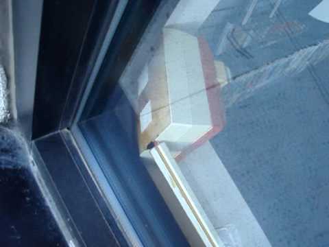

Here is what is probably a legit bad install: (I know this was 2 years ago but I thought I ought to share it)
Apparently instead of finding a nearby wall to mount these alarms on, or anchoring them to the metal door frame, the installer just attached them to the glass with DOUBLE-SIDED TAPE. And as you can see, the sun did it’s magic and it looks like the NA fell, and pulled the pull down with it.
Now it may seem cheap and it “works” at first, but clearly it did not.
Wow, now that is terrible. Double sided tape? What the hell is this, a first grade art project?
The fact that the wires come up from the bottom tell me it was probably done when the wall was open so my question is what contractor came back and put that full window in and installed those devices like that. Sorry I just cant see even the most lazy installer do that. But hey… its possible
They should have anchored backboxes to the metal door frame that was right next to the spot where those alarms were. That’s what I would have done.

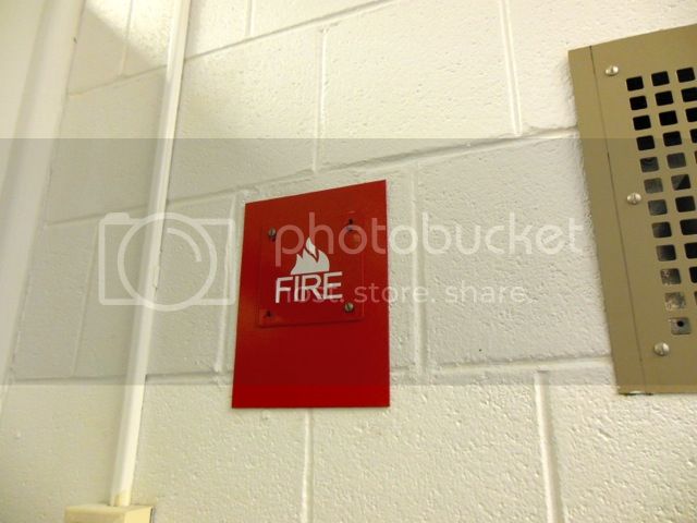

Here’s another bad install job to mention: the Gibbons Elementary School in Stoughton, MA. Built in 1971, they currently have a Silent Knight system with SpectrAlert horn/strobes, several installed on their own backboxes and conduit, but I also saw some slapped onto older light plates! However, these were a kind I never saw before: they were a bit larger, the size of 2903s or Standard light plates, and were flat and gray with a Faraday/4050-80 -esque red light on the bottom (blank lens), and at least one of them had a “BLISS/GAMEWELL” logo on the bottom, revealing the school formerly had a Gamewell system, and that Gamewell used to have their own visual alarm signals! (I think the old horns may have been Vibratone 450s.)
Get a picture if you can! I want to see that plate.
Is it like the unknown ones you found?

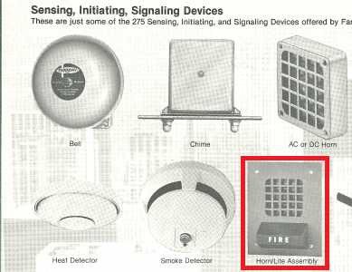

I think he means this light plate, which is shown below.
Yeah, I think that’s what they would have looked like without the SpectrAlerts, except they didn’t have the “FIRE” lettering and I mentioned one having a Bliss-Gamewell logo on the bottom, so Gamewell probably rebranded them.
On a similar note, I now see that Faraday rebranded those ESL detectors as well. Seems almost EVERY fire alarm company back then did so! (I’ve seen them from Edwards, Autocall, Simplex, ADT and FCI!)
