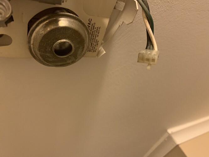

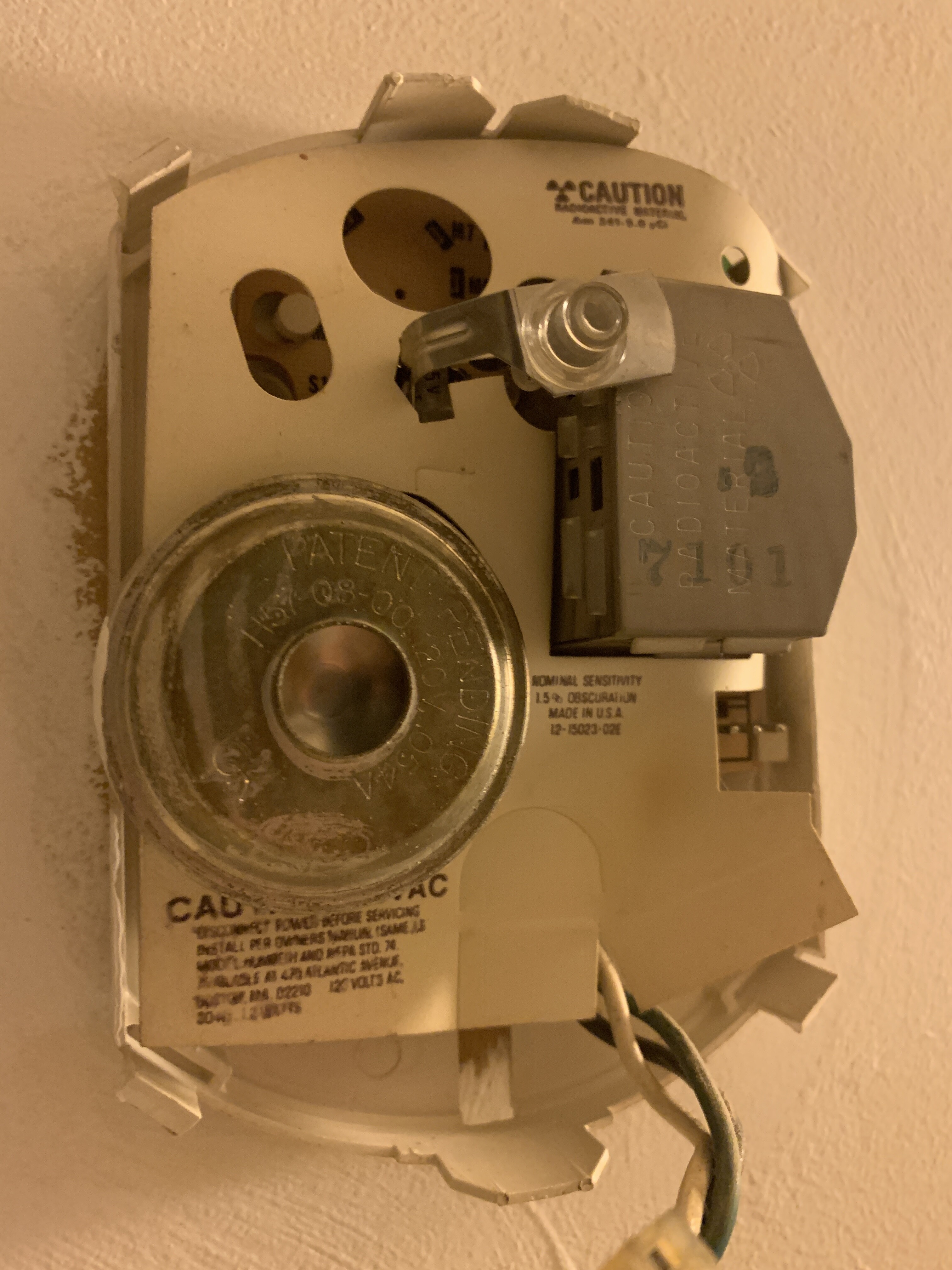

I have this old hard wired smoke detector on the 2nd floor with no cover. I believe it’s a BRK 769AC. It’s the only hard wired detector in the house. The other detectors are battery powered (non hard wired)

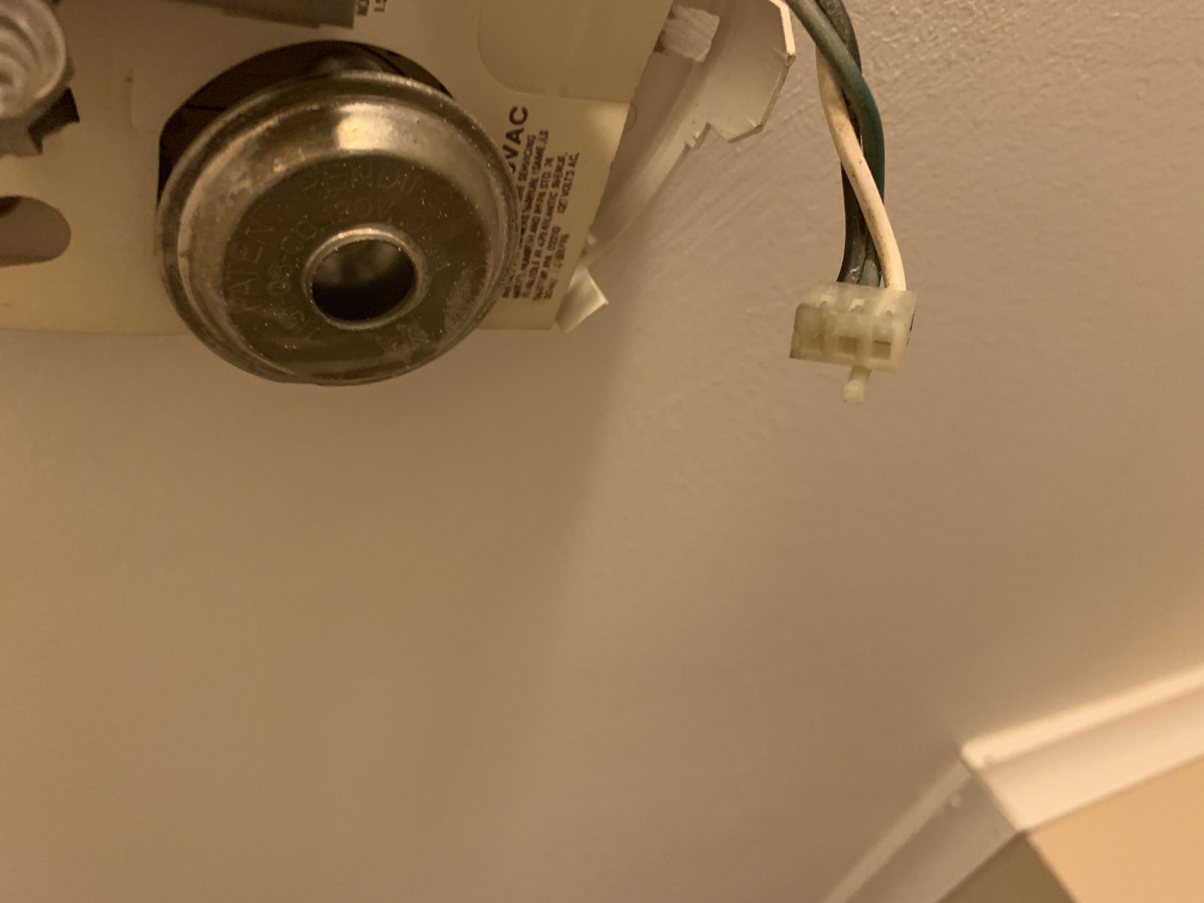

The 3 pin connector coming from the ceiling is so old and I don’t believe they make a suitable replacement. It has black, white, and green wires.
I believe most new detectors have black, white, and red wires.
So to replace would be the following?

It does indeed appear to be a very old BRK AC-powered detector: I would not advise cutting the plug off its power connecter though as that would ruin its condition; I would however advise you replace it (but just the same not throw it out!) as it’s well over 10 years old.
Would you happen to know where the cover is by any chance?

I know black wire goes to black wire and white wire to white wire.
Since there is only 1 hard wired detector in the house, what is the green wire for?
Green might be ground. A lot of wiring uses green for that purpose.
So tie the 2 black wires together and the 2 white wires and then put a wire nut on the single green wire?
I presume the new smoke detector will have a red wire. I gather a wire nut should go on the red wire as well?
Shame: a detector’s not complete without its cover.
Yes, but from what I’ve seen only some very old detectors have a ground wire: most of the time the third wire that’s not black or white is the interconnect wire.
The color of the interconnect wire all depends on the brand:
BRK/First Alert: Orange
FireX & USI Electric/Universal: Yellow
Kidde: Red
Generally, many AC units today do not use a grounding wire. Why that is I’m not entirely sure, but not even every consumer electric device we plug into the wall is grounded, so I suppose it’s not that big of a deal.

To install it, use wire nuts to connect black to black, and white to white. You won’t be needing the green ground wire from the wall, so put a wire nut on it, and maybe use some electrical tape to keep the wire nut secured to the wire.
As for the red interconnect wire on the 7010B’s harness, there’s usually a rubber cap installed on it from the factory. It’s there so that if you need to interconnect your smoke alarms, you’d pull the cap off and connect it to the red/orange interconnect line in the wall. Since you won’t be using it, just leave that wire alone, no need to cut it.
