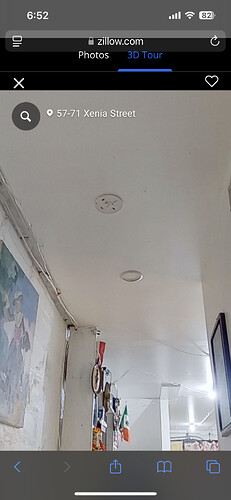

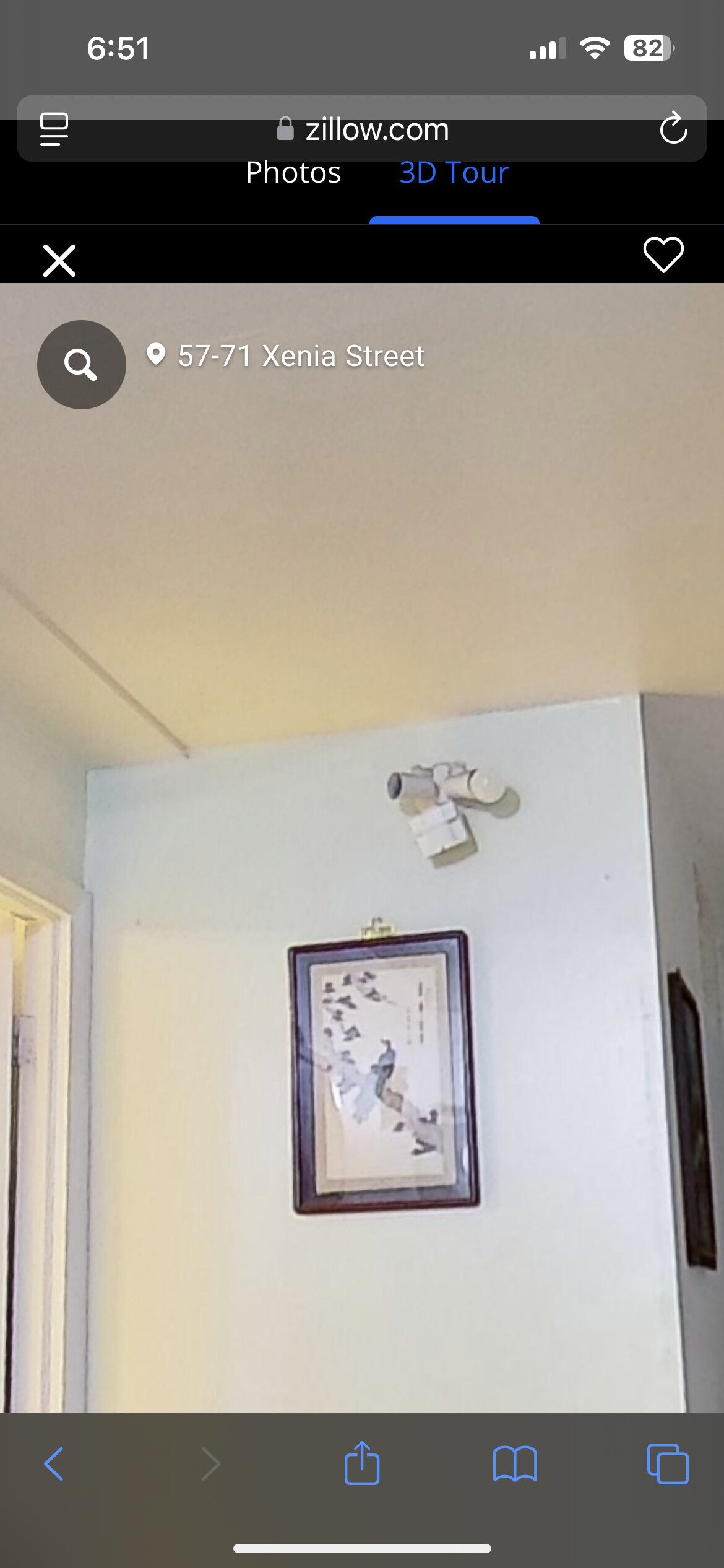

I was looking on Zillow recently and saw a multi family house with many life safety flaws. First, there were only sprinklers in the 1-4 floor stairways. No sprinklers in the basement nor units. I think in total there were like 5 sprinklers in this building. I did see this building was built in 2000s, but still, it’s crazy. It’s definitely better than nothing, but what if there was a fire in the basement, none of the sprinklers would matter. Second, this building has no fire alarm system. It has 4 units, with NINE bedrooms. Many of the units had smoke alarms missing/very old. Lastly is the missing exit signs and emergency lights. This whole building has zero.

Sheesh…yeah that’s a major fire hazard & likely many code violations alright (since last I checked multi-family residences are required to have a full fire detection & alarm system): even worse is the fact that what it does have likely wouldn’t be enough in a fire.

As I said previously, there are no sprinklers in the units, including the kitchens.
I doubt that. If they would have concealed sprinklers, they would probably have the little caps visible.
See the top left of the photo; based on context this looks like a shared kitchen/laundry area of the unit. That’s what I was referring to.
As for caps - sometimes the caps are so flat that they sit flush with the ceiling, and if the ceiling is painted and the caps are not taped off or removed, it’s possible to paint right over it and make it look like it isn’t there. Not saying that’s 100% the case, but not outside the realm of possibility.
