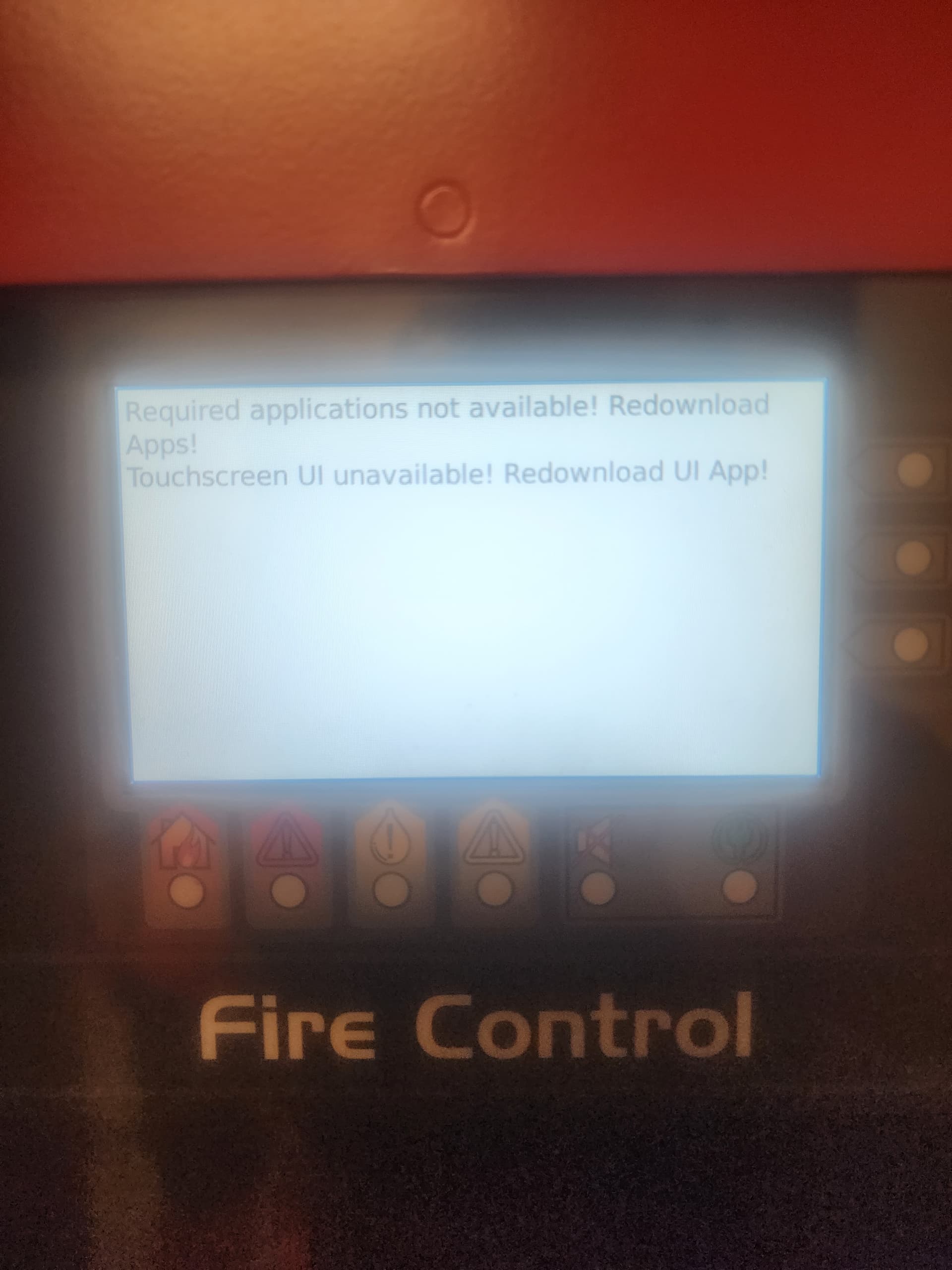

Falla panel 4007es
Tengo la siguiente falla como podria solucionarlo panel 4007es simplex

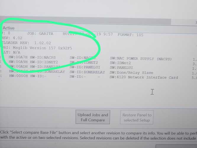

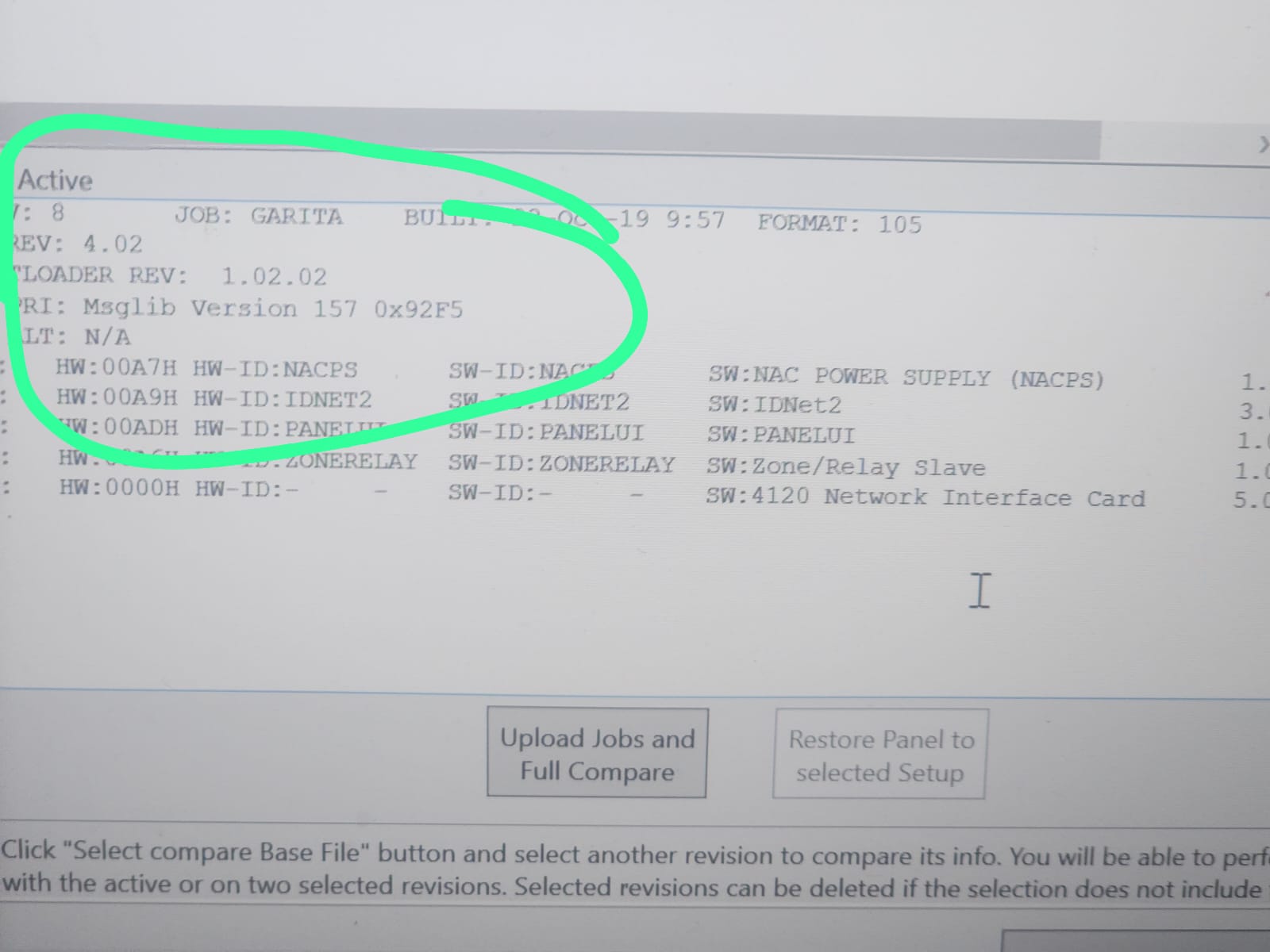

You just need to redownload the panelUI bin file to the fire panel, needs to match the firmware revision inside though. if you send me a copy of it, sometimes on a usb drive inside, i can prepare the right bin files for you.
4007 panel bin compatibility list.pdf (4.0 MB)
It’s pretty low risk, i would only add the panel UI file for download. If you somehow mess it up, its on you.
Tenia esta version tendras los files para poder solucionarlo muchas gracias
