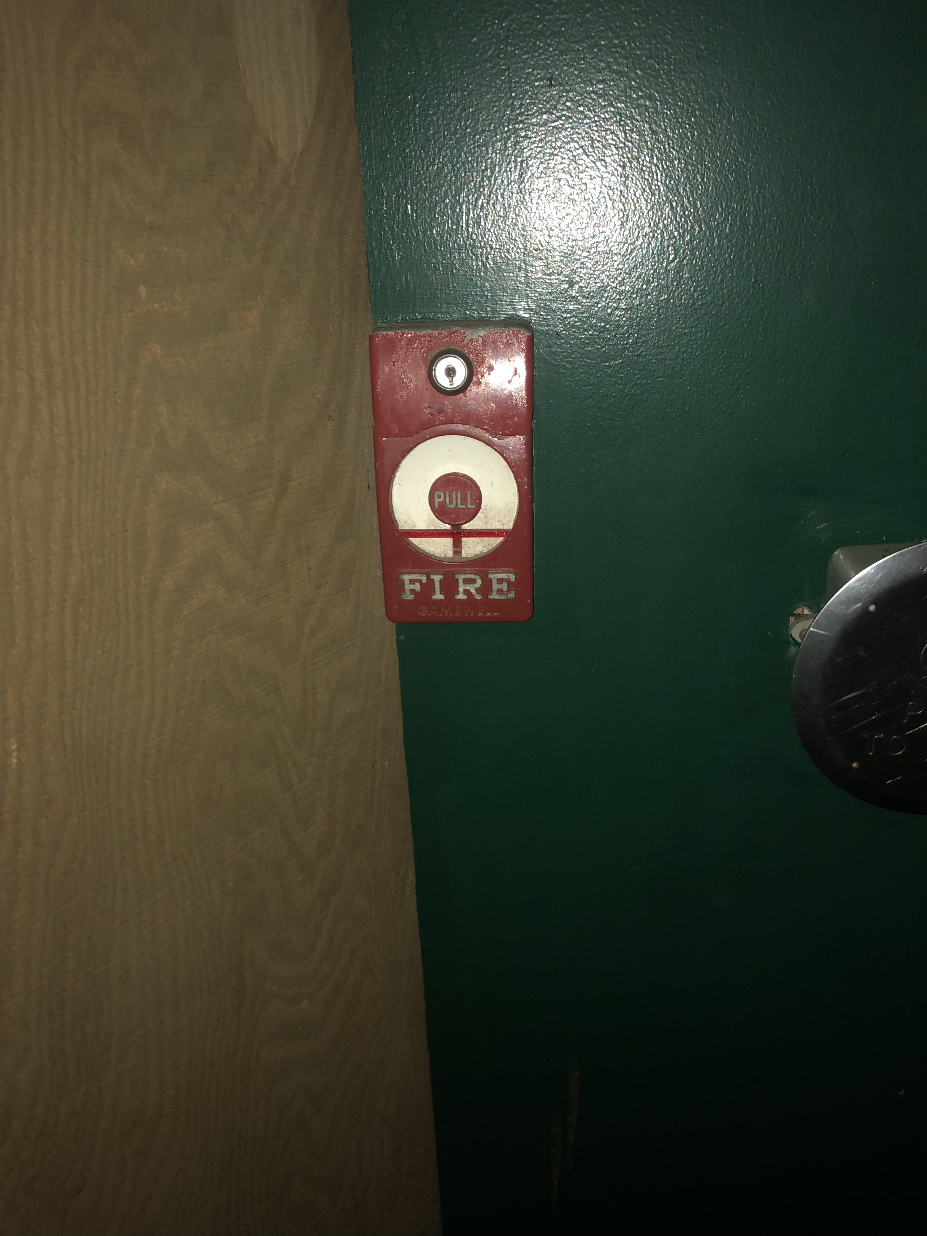

Pulls - for the most part Gamewell sentry pulls, with the key lock instead of the screw.

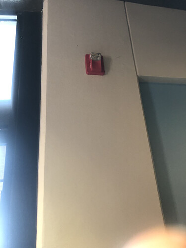

Most of the notification appliances in the jungle area are Gentex. There are a bunch of SHGs, but there are a few Commanders as well.

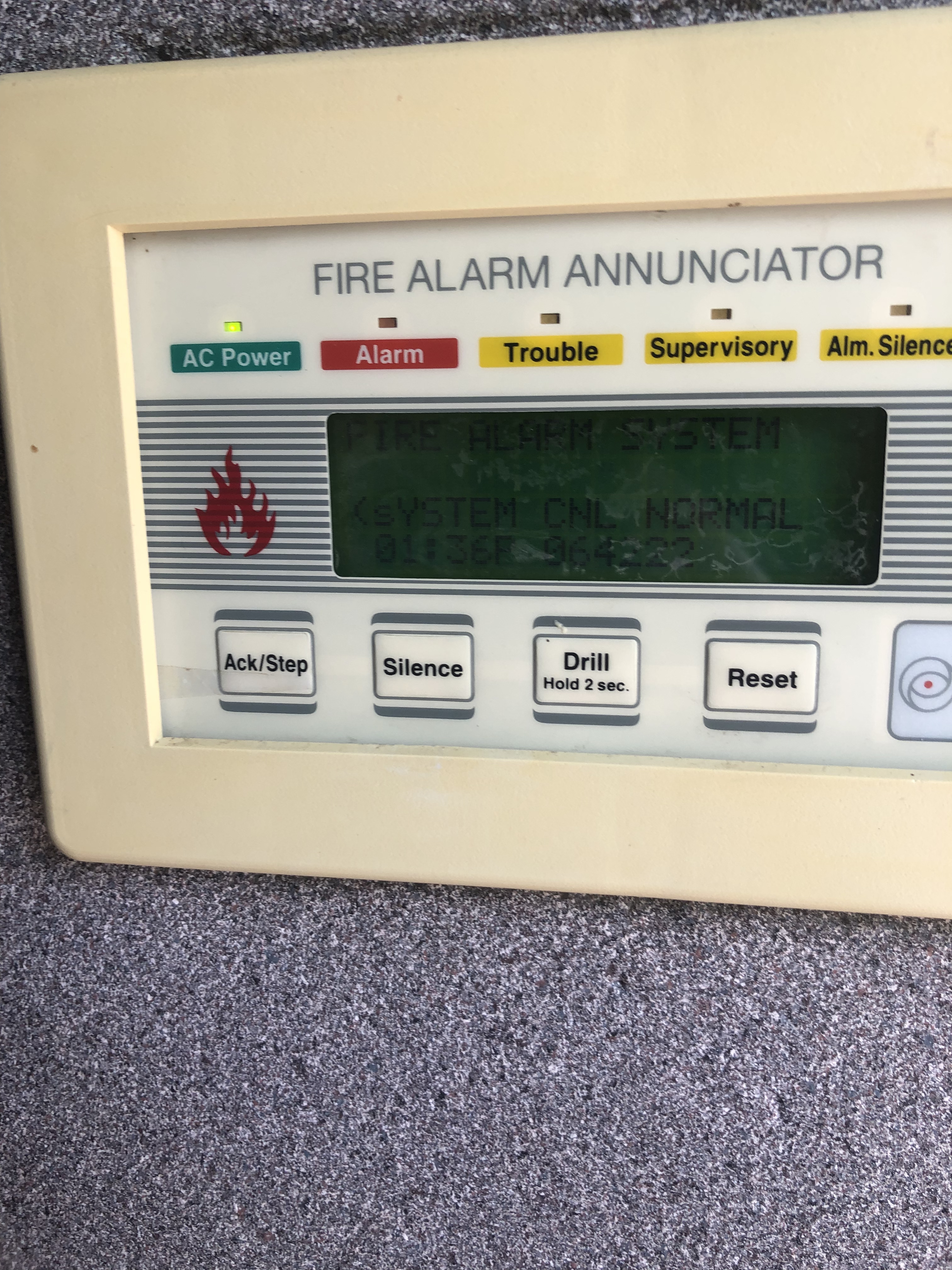

Also here is the building’s annunciator. Last time I saw it, it was displaying the date as being 1999. So evidently they don’t set the time on these panels or something.

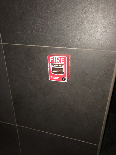

Now to the aquarium. The system is a Notifier system of some sort. It is voice evac. The pulls are NBG12LXs. The NAs are SpectrAlert advance speaker strobes. There are a few FSP-851s floating around as well.

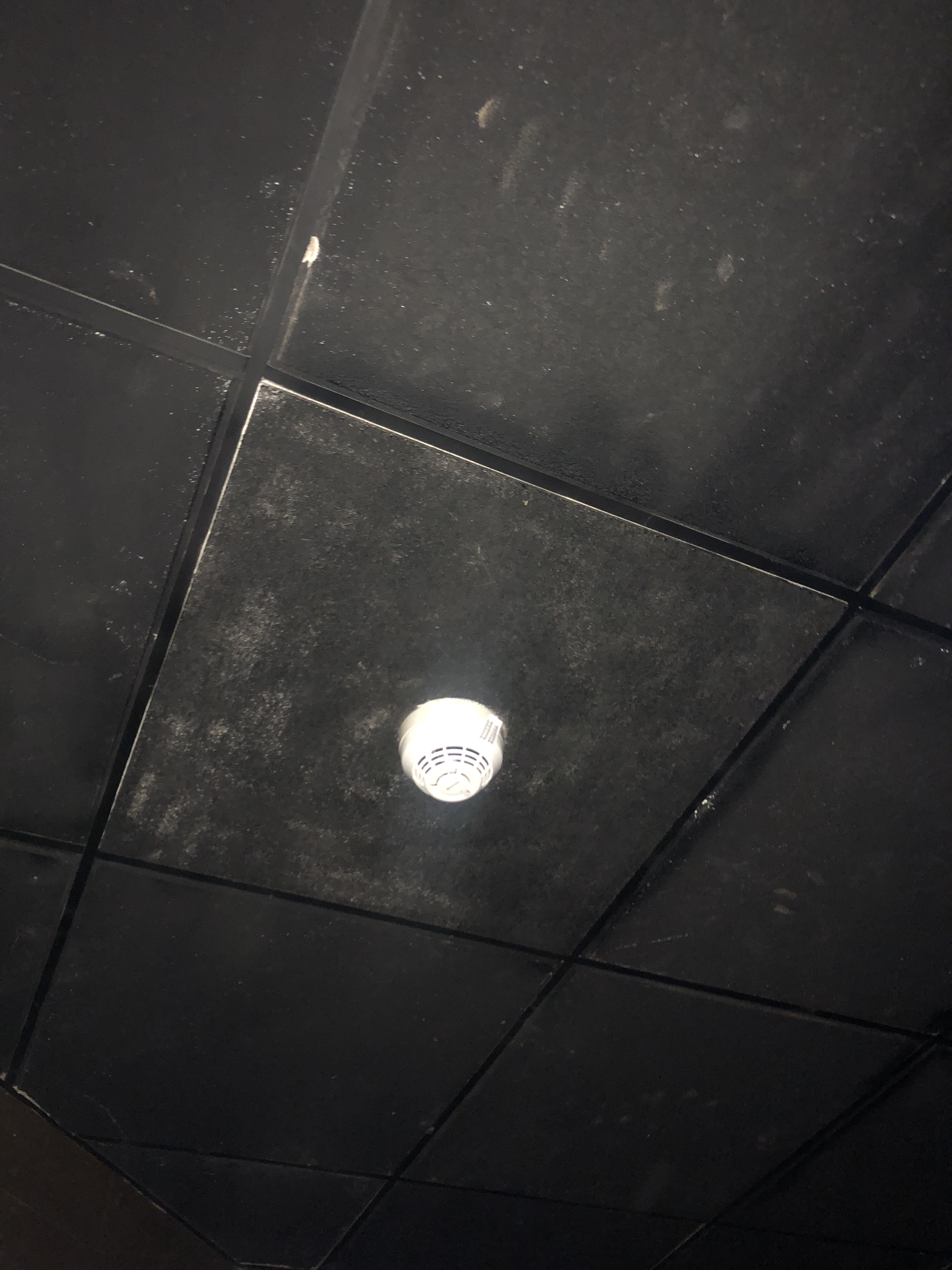

Next up is the Desert Dome. This system is an EST3 system. The pulls are most likely SIGA, and they are 278s. There is a mixture of generations of EST SIGA smokes and heats. There are also at least 2 panels in charge of controlling the fire suppression system inside the desert dome. In this building there is also a downstairs area, which I have more images of than the upstairs. The system has Gentex Strobes, and I don’t know what the speakers are, but they are separate from the strobes.

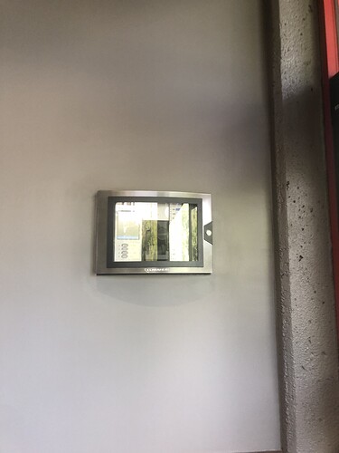

Oh! I forgot that I have this photo of an LCD-80 freaking out. The system is at the Butterfly and Insect building, the system is a Fire Lite system, it has voice evac, and the NAs are Spectralert Classic speaker strobes. I will get some more images of it next time if I have the chance.
Oh, huh.
You don’t see a ceiling-mount GX-90 every day!
Yet another instance of the LCD on a panel or annunciator going out…
How common is this issue?
Seemingly somewhat common considering weatherdan882002 has documented it happening on two different systems:
