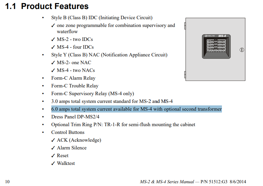

Looking in the official Fire-Lite manual for the MS-4, a second transformer is an intended and supported feature. You can check out the manual here.
Oh, really? Huh, had no idea. Still though: be sure you know what you’re doing while putting one in!
