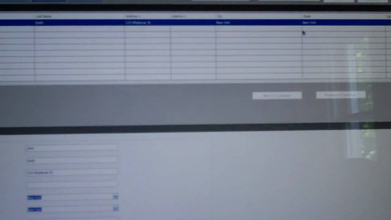

I haven’t used PS-TOOLS since I had an MS-5UD, but it’s very straightforward and easy to use. I don’t think you’ll have any problem figuring it out.
Here’s the user guide:
http://www.firelite.com/manuals/PSTools_MS5_10%20Zones%20UserGuide.pdf
Here’s an old video I made that demonstrates the program. Sorry for the crappy quality.
