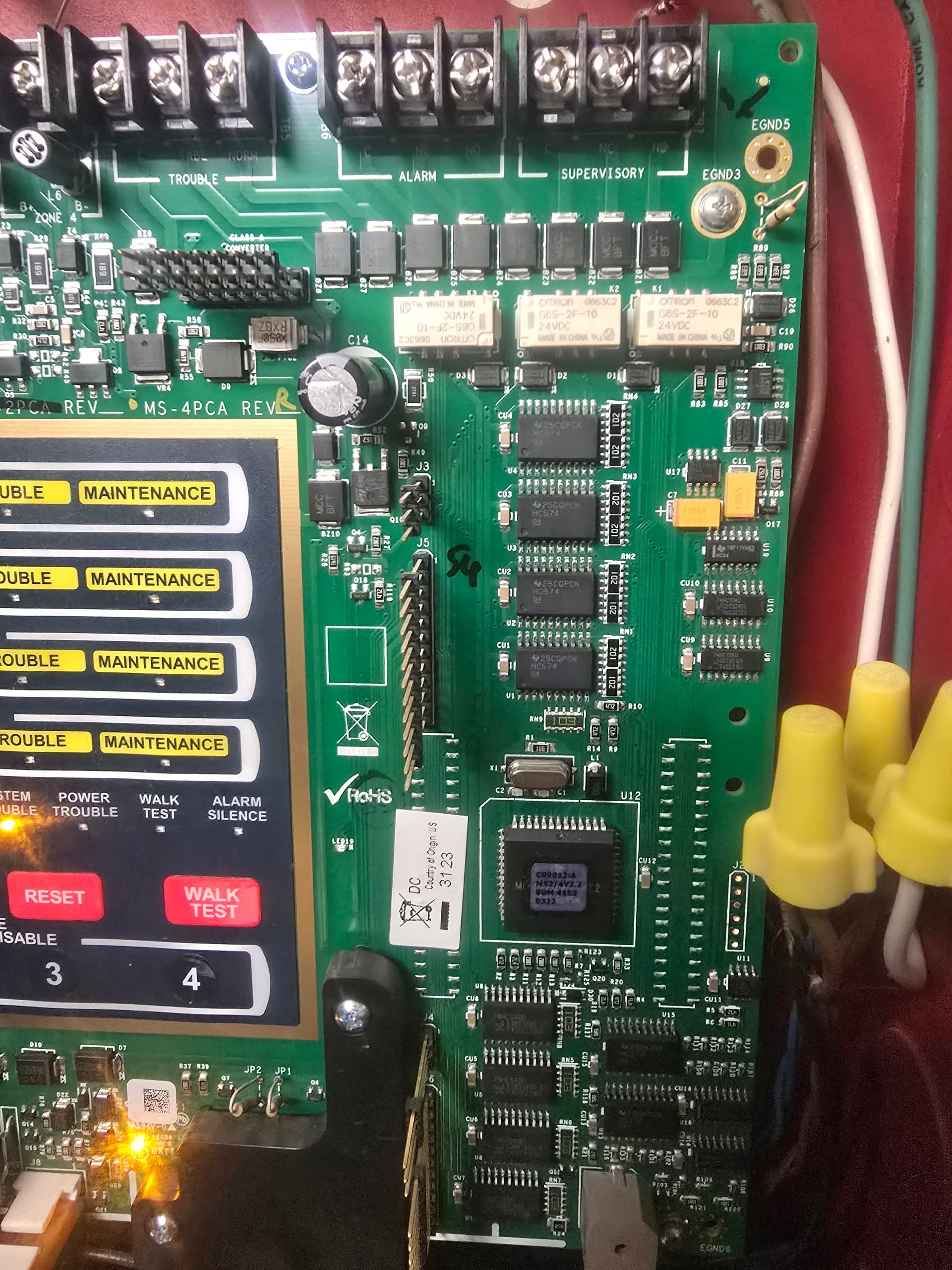

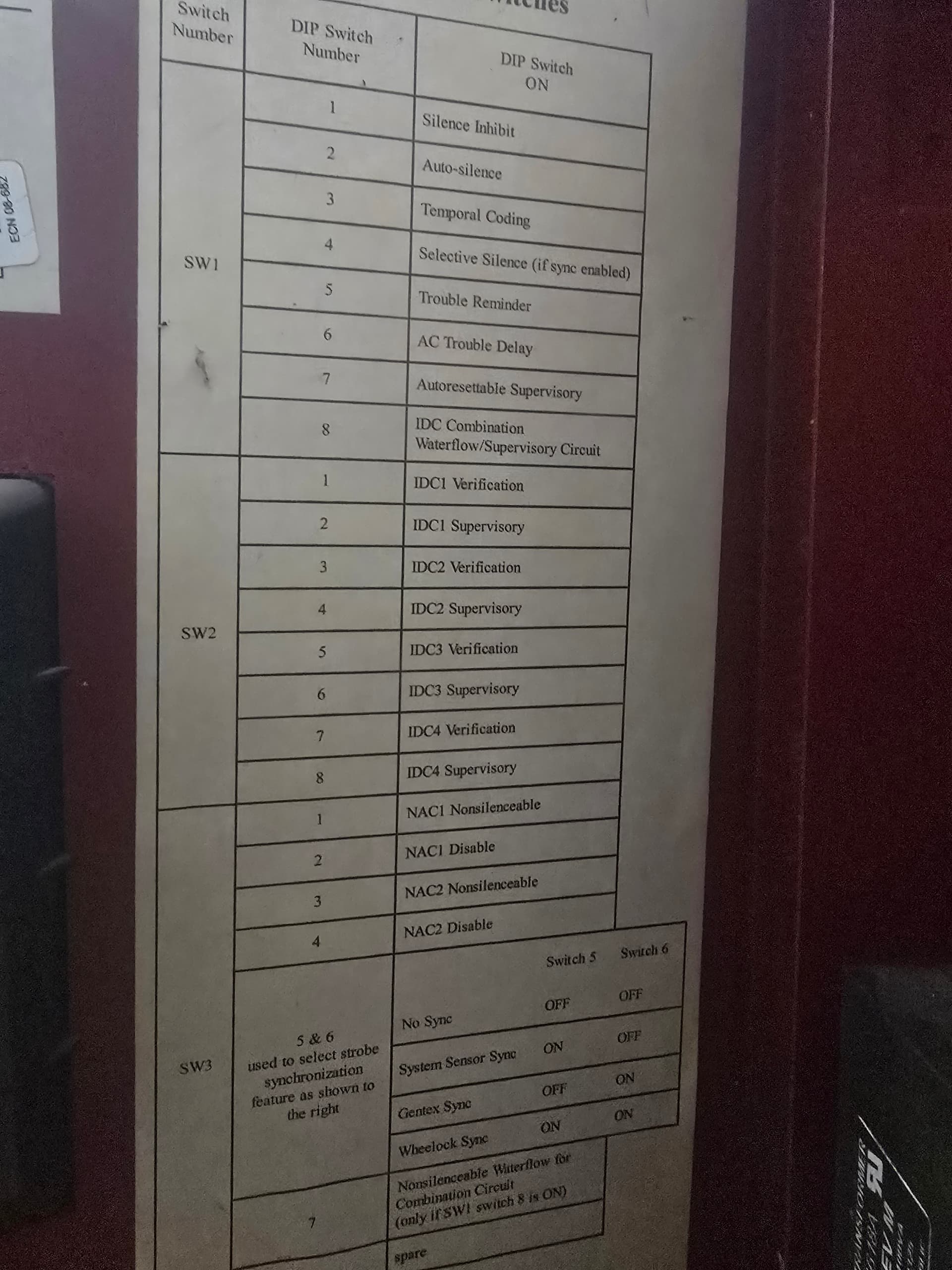

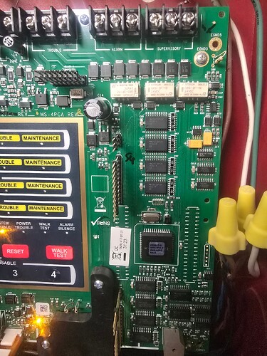

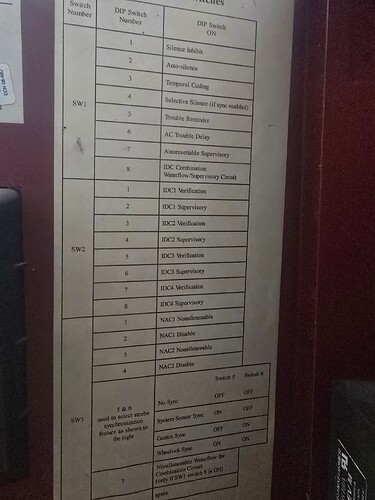

I’m having a ground fault trouble notification on my MS-4. We hit the ack but it will start beeping again after 5 minutes or so. I’ve been doing some research. I looked at the dip switches but number five on sw1 was already off. It doesn’t work as expected. The noise is really annoying to the tenants.

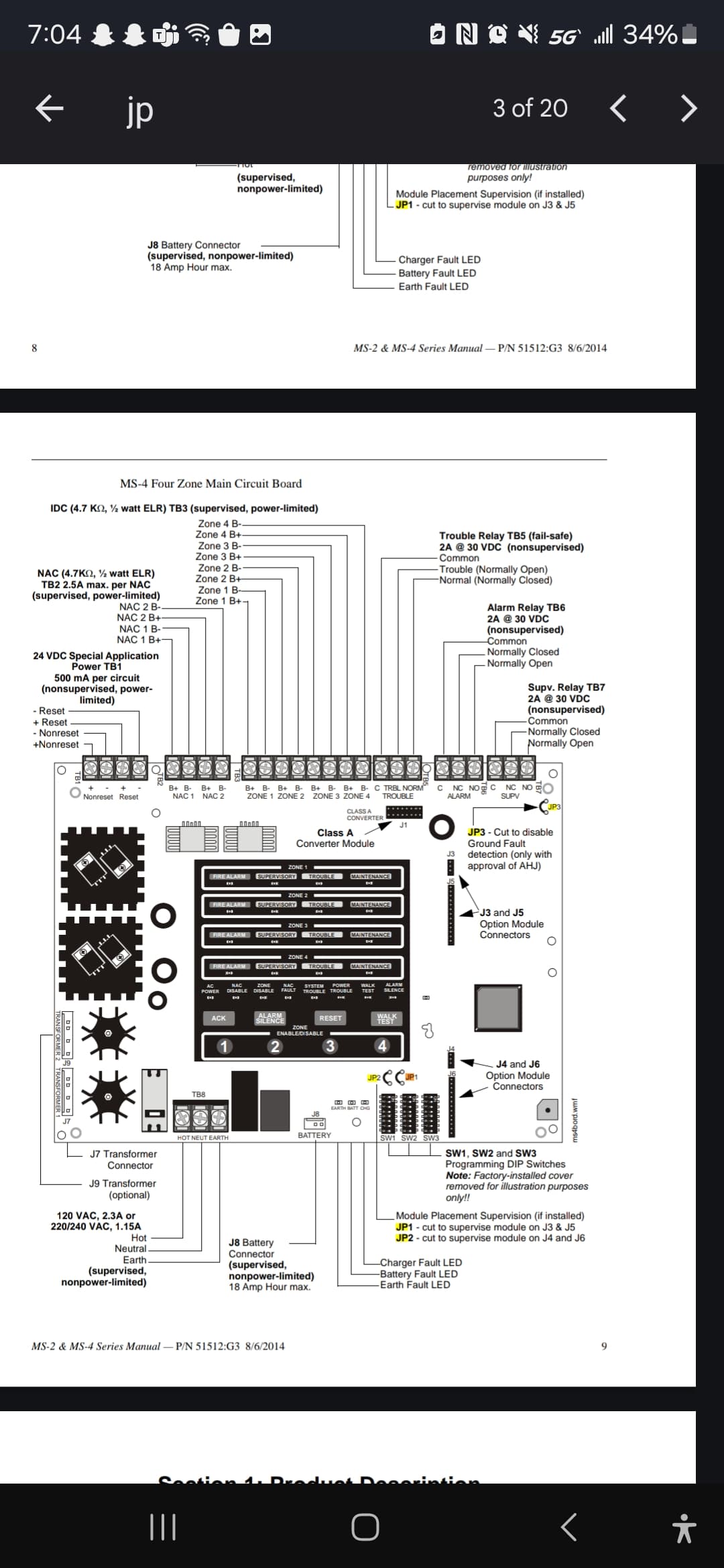

At this point, silencing the alarm would be a nice and deserved stopgap. I don’t plan to cut Jp3 anytime soon for obvious reasons. I just want solutions.
