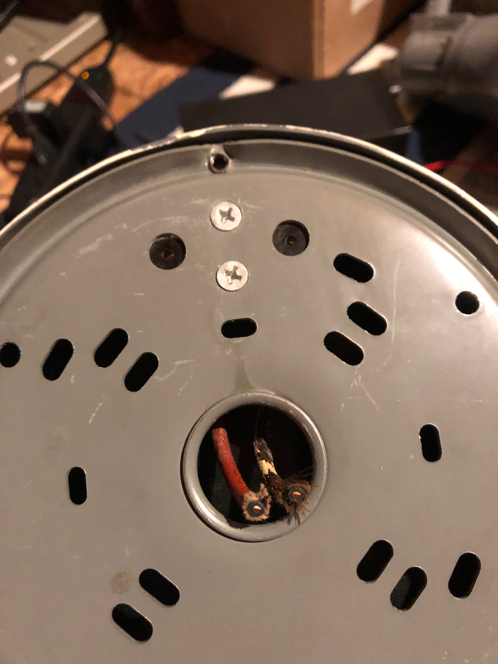

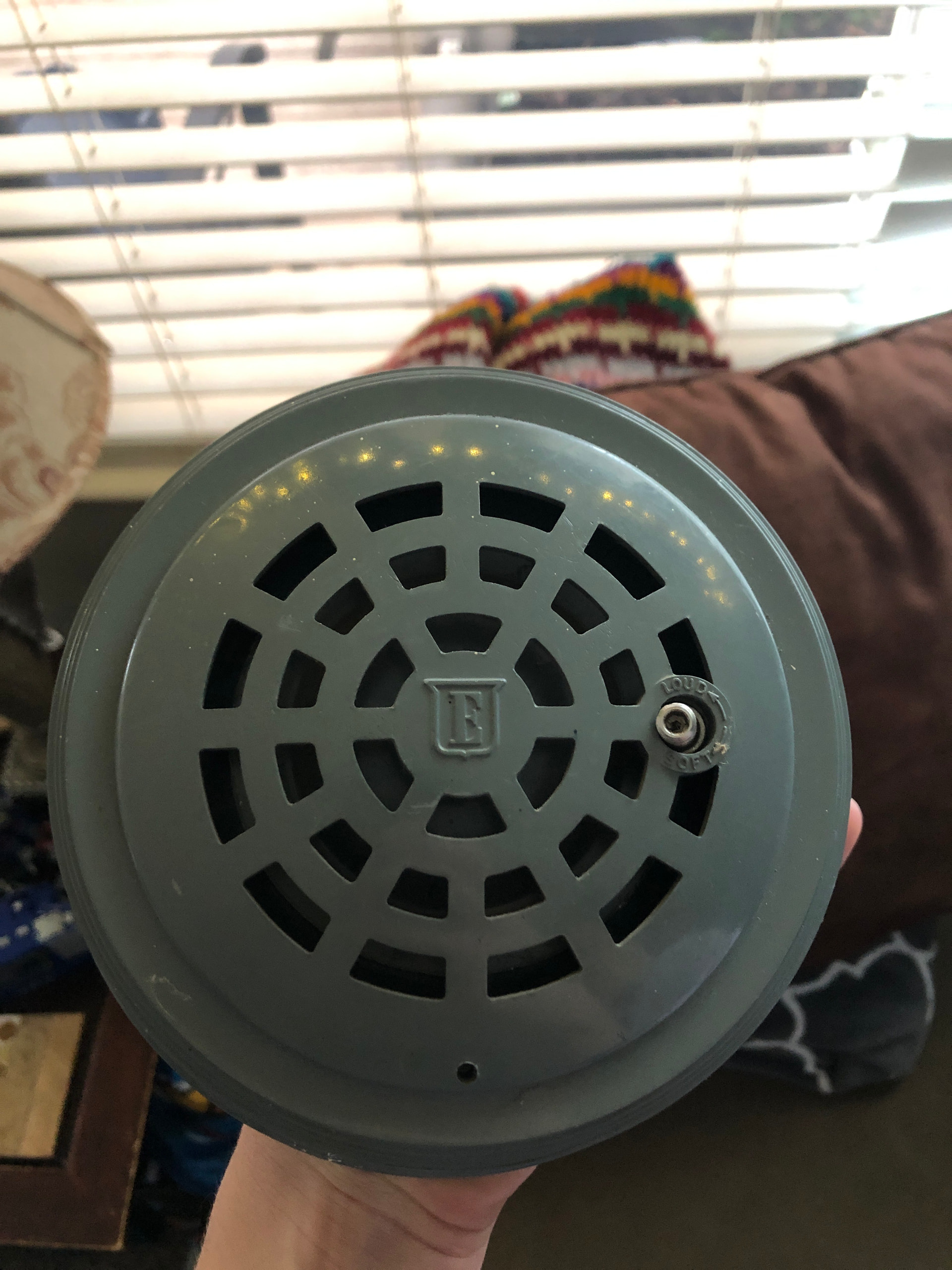

I got an Edwards Adaptahorn 374 for Christmas. However I don’t know how to remove the back cover or power it on. It has 2 Wires coming out the back. One is Red and the other is White or Black.
There should be a screw underneath the bottom of the horn: remove it & that should allow you to pull the mounting plate off (also make sure to check the voltage on the label & only power it with said voltage (which you might need a transformer for).

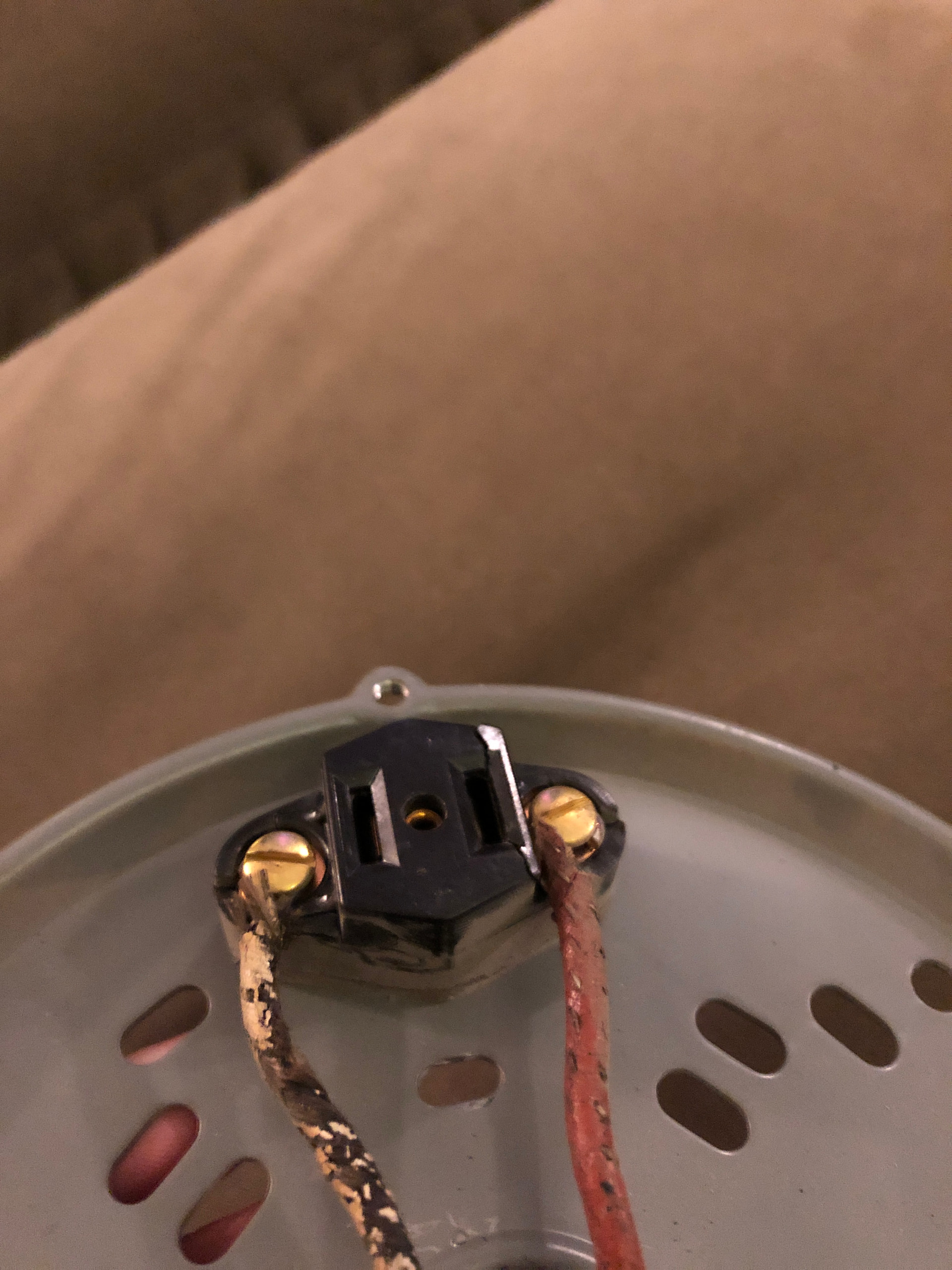

I was able to get the plate off (with a bit of force) and I noticed it has an (Outlet Plug?) of some sort. Does this plug into an Outlet?

No: the plug on the back of the horn connects to an “outlet” of sorts on the front of the mounting plate (the latter of which is connected to a power source via two screw terminals).

Would I remove the Wires that are screwed into the Terminals then plug in the wires I’m going to use?

No: leave the wires that connect the terminals & “outlet” together & attach external wires from the power source to the terminals via the screws on them.

So I leave these Wires connected and use Wire Nuts to connect my Wire Cable?

Oh, you mean those. No: remove them & hook your power source wires up where they were.
