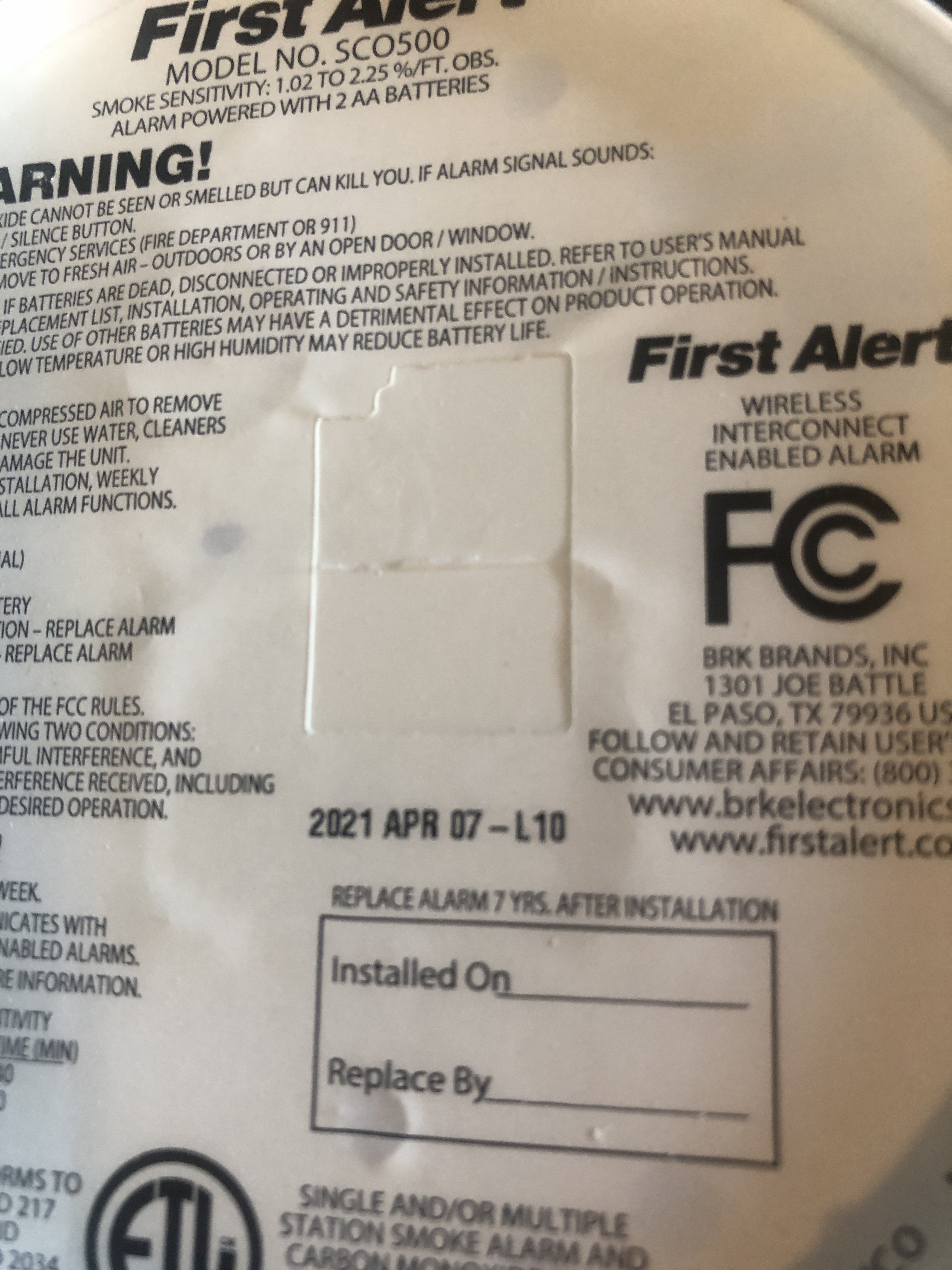

First thing I would do is look on the back of the alarm, If you can’t find a date you may need to look for a 5 digit number. For example 10364, The first two digits(10) are the year (2010), and the last three digits are the day (364th day of 2010)
Hope this helps!
Example If you can find the date (That would include taking it off the wall to see)
