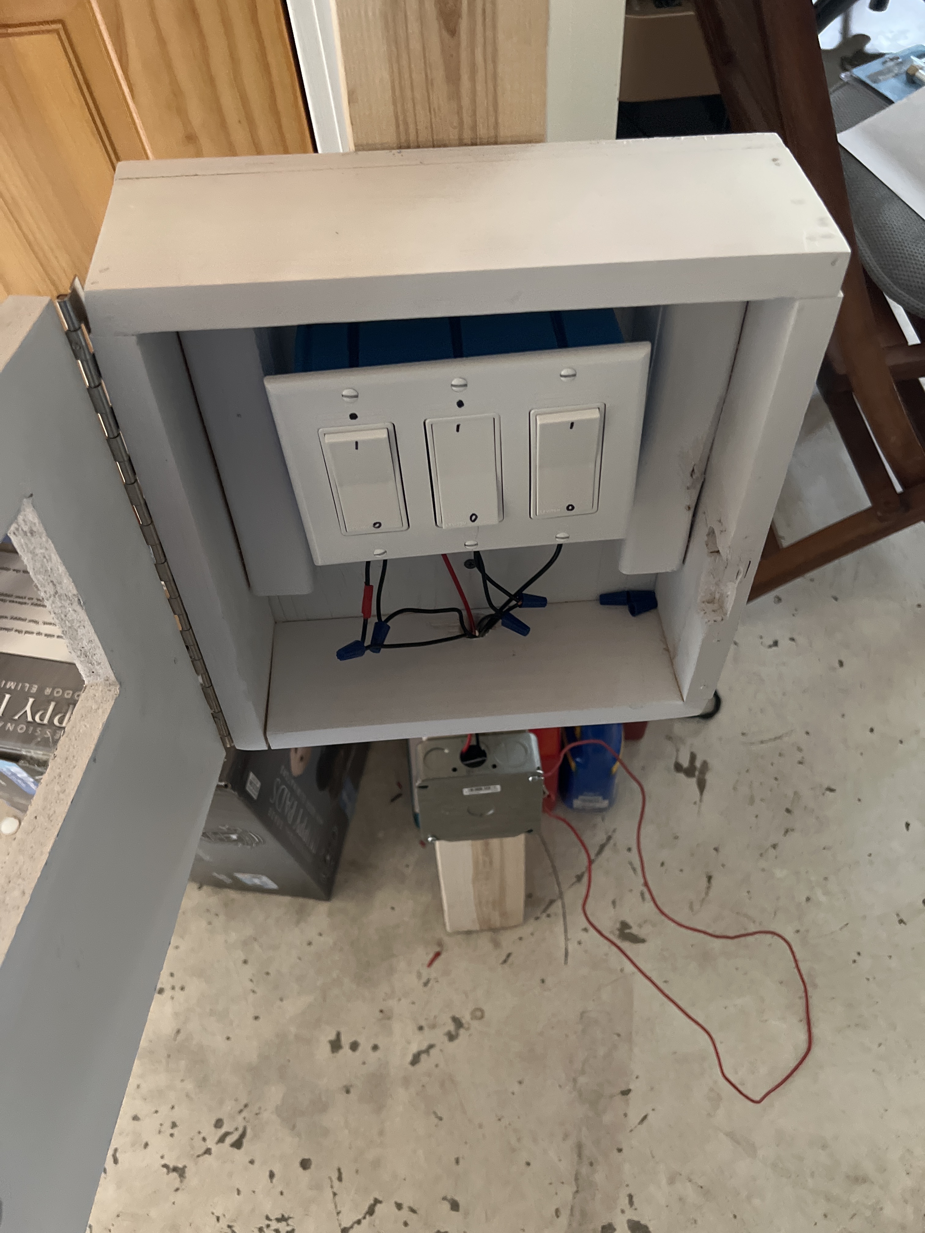

How to add coding too my pannel
So I recently built this homemade pannel which is pretty basic but good enough for me. However I’m trying figure out a way to add coding somehow because continuous is annoying after awhile. Is there some sort of module I can buy with a code 3 option?

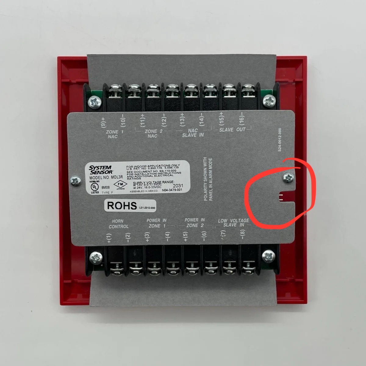

You could go with a System Sensor MDL3 sync module. If you put in the temporal jumper (circled below), it will output a temporal pattern rather than a sync protocol.

Would this work?Nano V3.0 ATmega328P CH340G 5V 16M Mini-USB Microcontroller Board | eBay
It could work, but it would likely require a lot of coding and other equipment such as relays. If you feel knowledgeable enough to make it work, go ahead, but otherwise I would recommend the aforementioned System Sensor MDL3 sync module. That sync module can be used to sync System Sensor devices just like any sync module can sync devices from its respective brand, but if you put in the jumper as seen in my first post, it will just output a plain old temporal coding that can be used with any horn.
