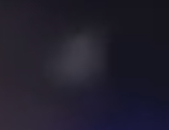

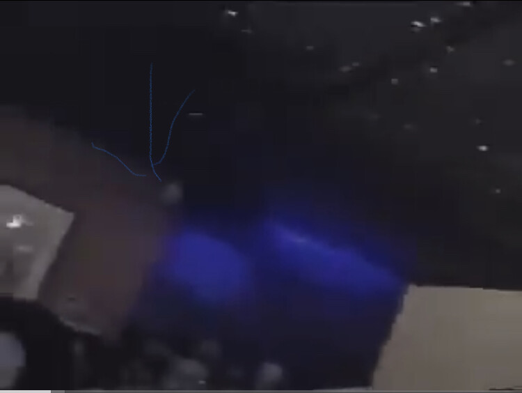

I found a YouTube video of the Station Nightclub fire and took a screenshot of what looks like a Wheelock MT.
As you can see, there is a crap quality picture of the white strobe housing as the MT or LSM strobe would have.

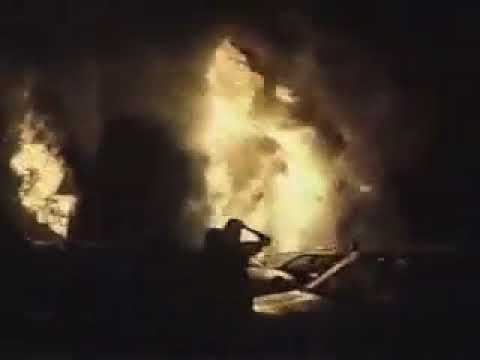

Here is a picture from the video not zoomed in.
This is a link to the original video. As you can see when the wall in the second picture is in view, a strobe flash can be seen.

It had Wheelock MTs, you’re right. Panel was an ESL 1500.
I took a screenshot of a section of video that shows the panel. I also found an emergency light.
