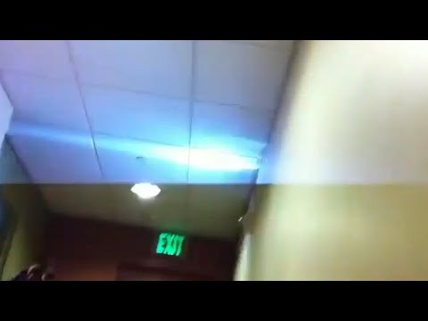

I know of this video that shows an issue where it is stuck on part of the voice message:
Yeah, it definitely seems like a glitch, breaker failure would have caused the battery backup to kick in. It also depends on if the system was activated and then the glitch occurred or the glitch caused the system to play one of its tones repeating a short part of it. Some systems are more prone to glitches and troubles due to issues with the software. Fire alarm system can go years without a full restart as they have to be active 24/7. Issues can especially arise with older software revisions.

Here’s another example of an MXL-V system malfunctioning:

The system you mentioned, an MXL-V, is setup in a configuration with hundreds of speakers scattered around the building, as well as a primary source for the audio for said speakers (this is called an Audio Controller, in most circumstances). In the videos that aerhardt and Carson linked, a failure of that audio controller caused a partial message segment to be played over and over during the alarm condition.
However, I believe that since this is simply a continuous tone, something else may have failed in this circumstance. Fire alarm systems typically supervise all speakers that are connected (supervise in this case means that the panel is ensuring that the wires running around the whole building to each speaker have not been broken or disconnected in some way), and this is done using a static tone which is played over the speakers, but is not audible in a normal condition.
Taking a look at the Manufacturer Datasheet, there are 4 possible things that could have failed to cause this to happen:
  • ACM-1 Audio Control Module
    • This was the source of the failure in both videos linked in previous replies.
