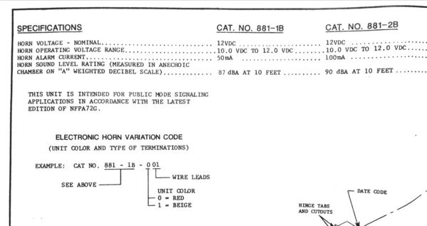

The 881-1B appears to be a 12VDC version of the 882-1B. Here are the 881-1B’s specifications:
In comparison, the 882-1B is a 24VDC horn with a current draw of 36 mA.
