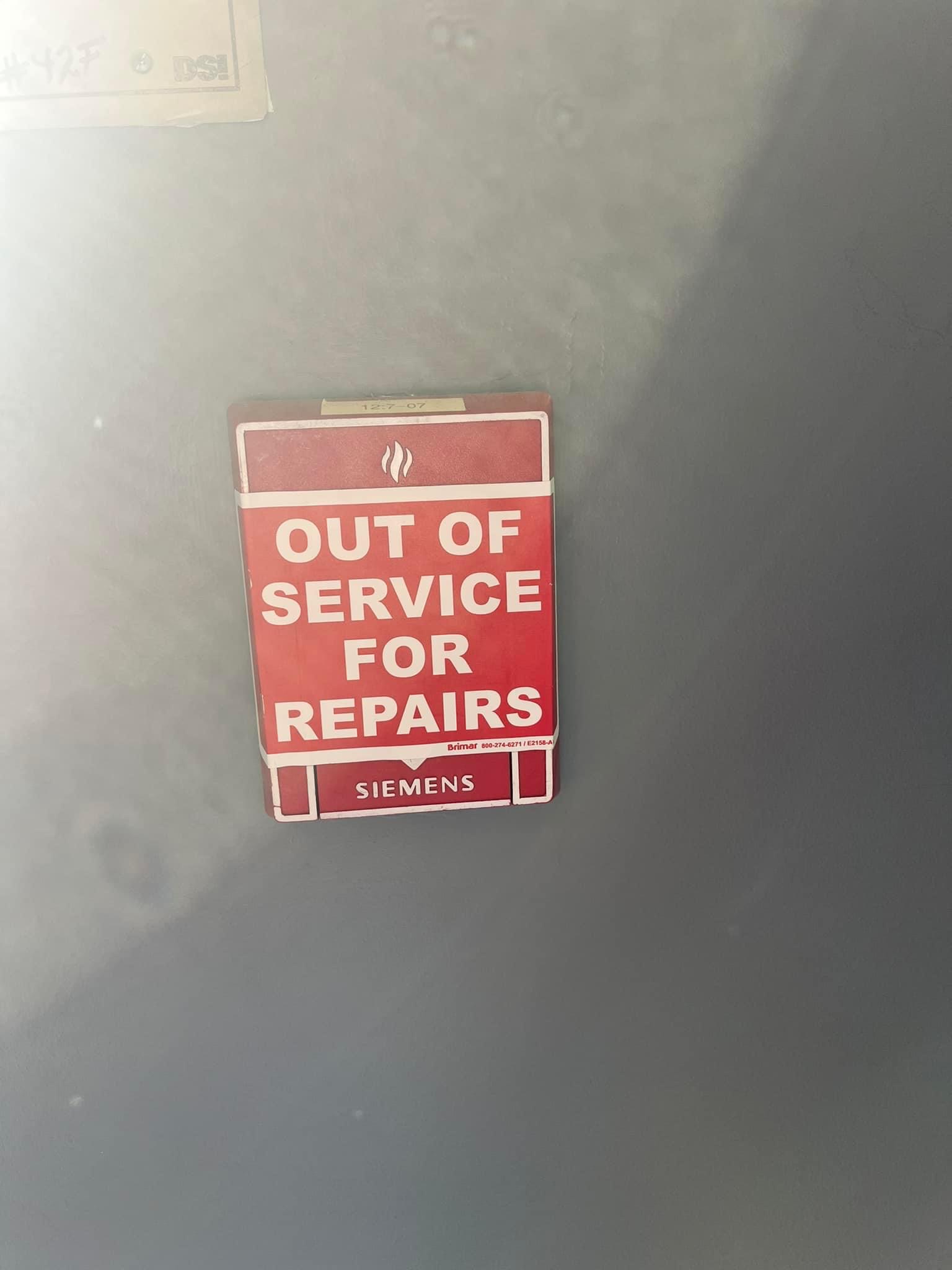

From the NICET Fire Alarms group:
This seems like a better way to denote out of service pull stations.
I think they could have stuck a mini module behind that pull station at least! Or replaced it!
