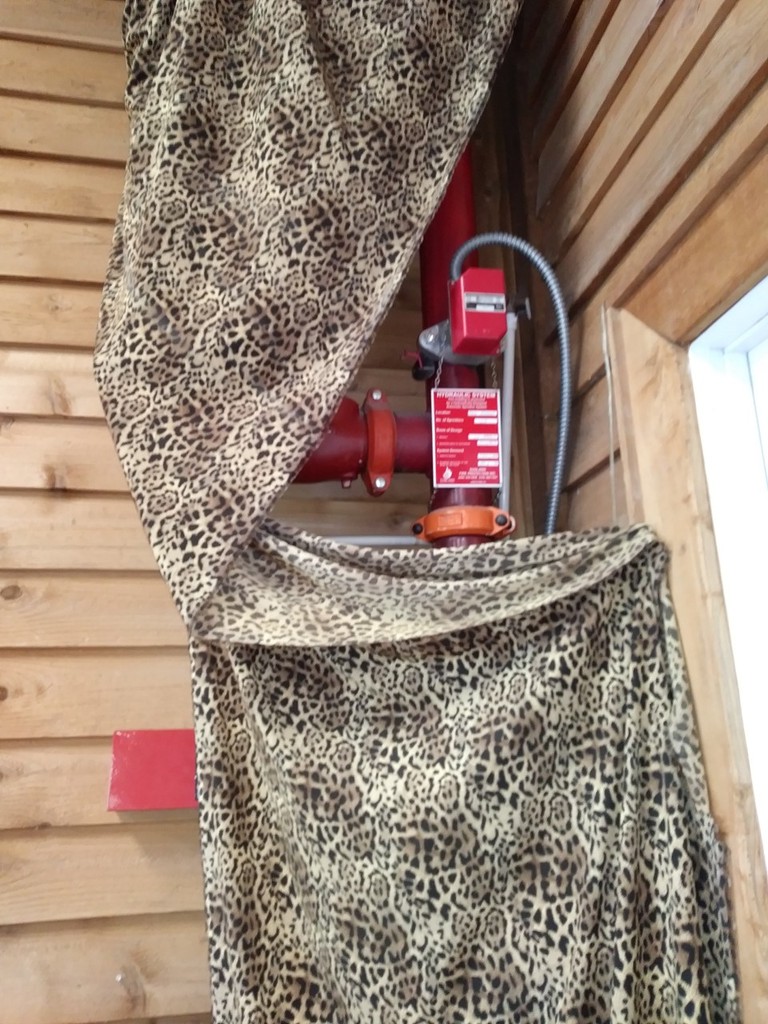

I saw this at a pawn shop in the tools area. I do not get why it is in the sales floor because someone can tamper with the sprinkler riser. Can someone explain? P.S. I am sorry about the size :expressionless:

Is that fabric trying to cover it up or is it for sale?
Its covering it
Not doing a very good job.
Yeah I agree
It would have been better to build a cabinet around it.

I would build a room.
Or try to have it put in a room
It would be better to put it in a room for sure, but I’ve seen worse. We have some older buildings were sprinkler risers/flow points are in peoples unit! Even if someone tampers with it, that valve should be electrically supervised, so if someone even moves it an inch or two it will send a trouble to the fire panel (supervisory in newer panels).

Yeah but they have no alarms :? . Just a few I3s and thats it.
I honestly wouldn’t mind living in an apartment that has a sprinkler riser/flow point in it.
Ok. So now the fabric horribly covering the riser has came down a little bit and now its kind of strange because they have a pressure valve like the ones on water heaters. And it’s conduit is broken off and the conduit leading to the flow switch is just a wire hanging for dear life. :?
Probably got nailed by the fire inspector
