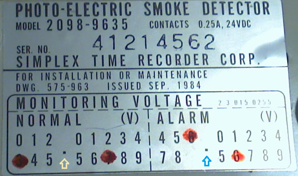

And this lead me to a question: For the smokes, I have four 2098-9636 heads on the 2098-9637 bases. On the back sticker of the heads, I see on the a blue section printed under the serial number on the sticker. The blue section says “Monitoring Voltage” which is split into “Normal (V)” and “Alarm (V)”.
What I find very confusing is that each sticker has a red dot on a different combination of numbers. Example:
#1 – Normal = 2 and 6 ; Alarm = 6 and 5
#2 – Normal = 2 and 0 ; Alarm = 6 and 0
#3 – Normal = 2 and 6 ; Alarm = 6 and 3
#4 – Normal = 2 and 6 ; Alarm = 6 and 2
I didn’t find any specifics in the documentation, so thought I would throw this out there…
Thanks again!
-Cheers, Peter.
I found a 2098-9635 in my equipment collection which has a similar label. There is a dot between each set of numbers which I think is a decimal point. I drew some arrows in the picture below.
I think these voltage specifications have something to do with the sensitivity testing boxes used at the time for these detectors. The test boxes had a test point output for connecting a voltmeter. The red dots represent the voltage levels at time of manufacture for comparison with field measurements. The voltage reading was used with chart to determine if the detector was at correct sensitivity or was out of range.
