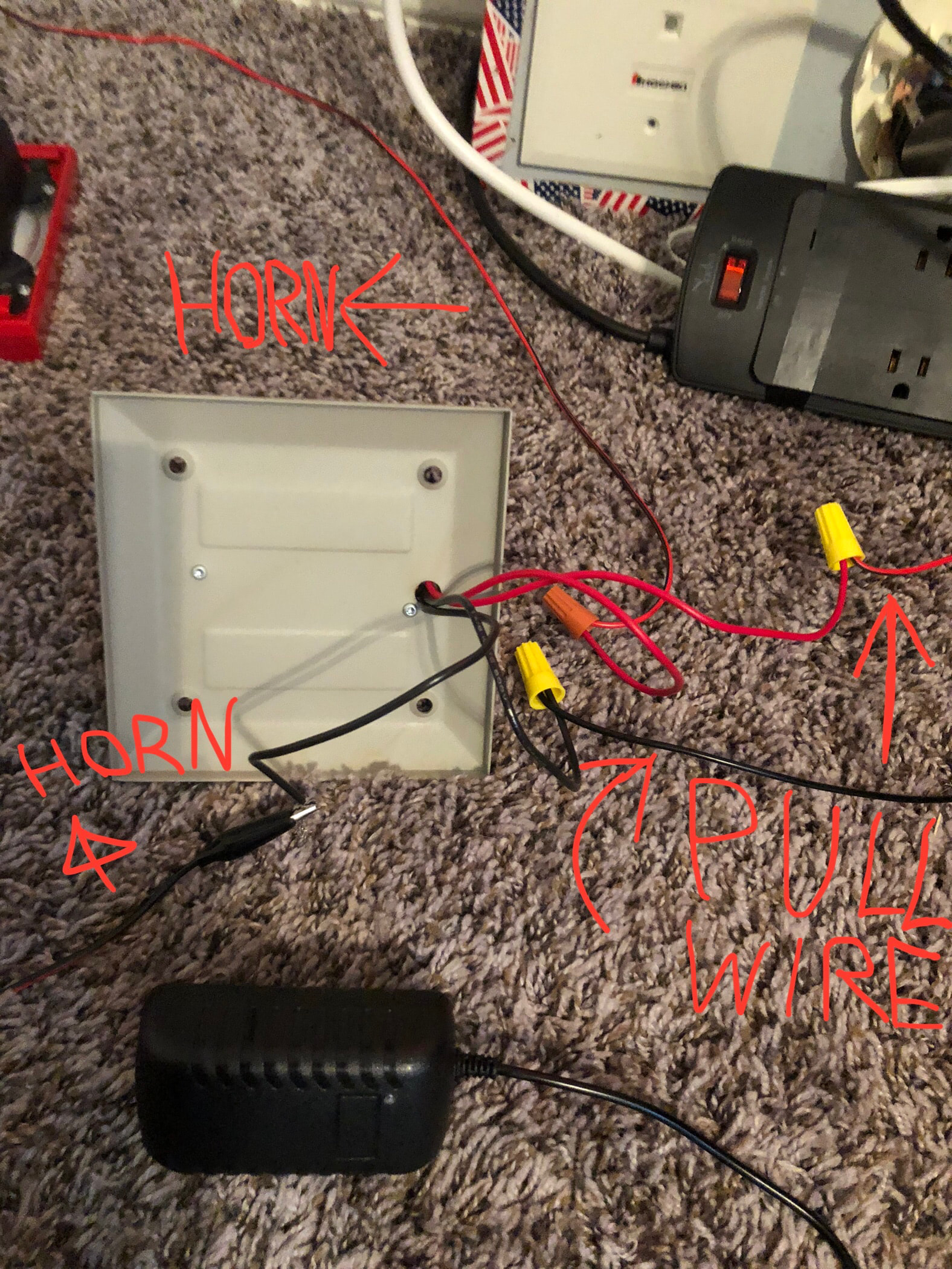

So like wire the positive and negative from power supply to pull station to strobe to horn?
disregard previous message i misread it
yes you can

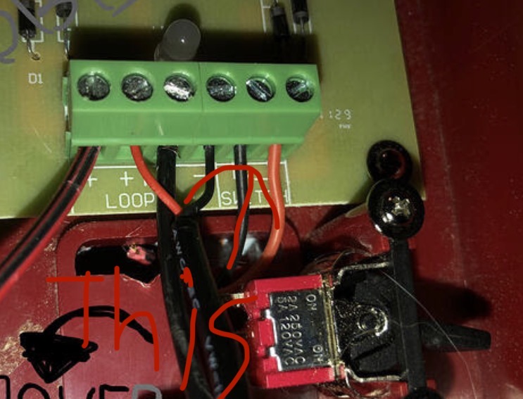

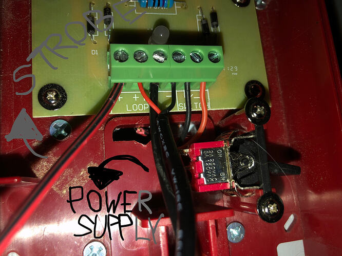

Alright I tried it, when I plug the power supply in, the 882 sounds and strobe flashes when the pull is normal and same even when the pull is activated, here’s some photos
if you look in the second pic theres 2 screws labeled “switch“, wire it to those
thats what I was trying to say
Oh ok thanks! :+1:t3::grinning_face: I needed that!
Wait do you mean the power supply to the switch?
ik its bad but the last 2 terminals
the ones physically above the switch
polarity should not matter as it’s literally a switch

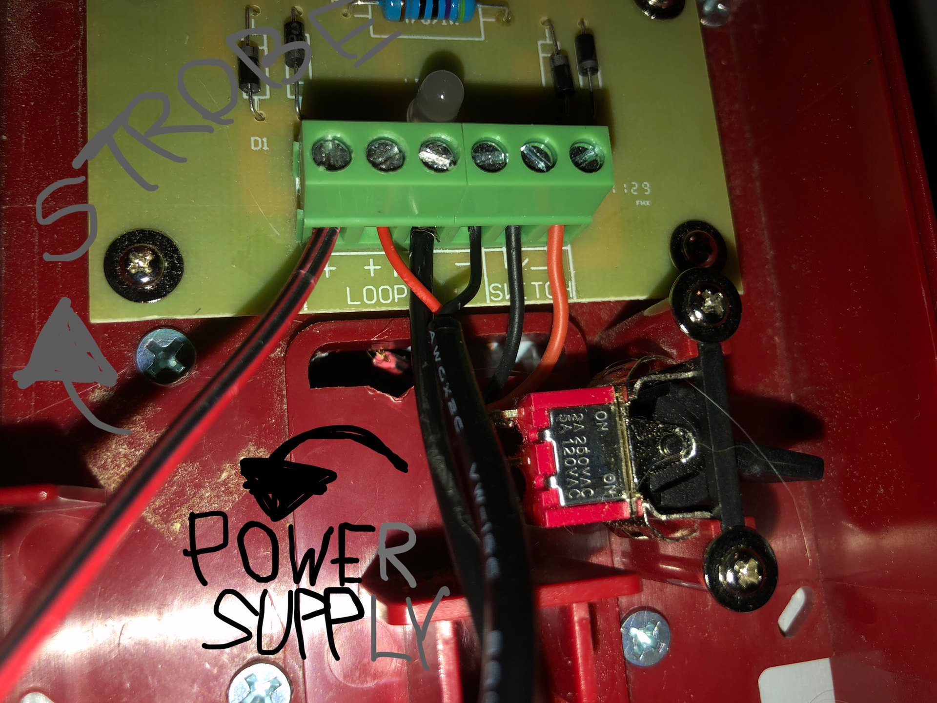

Oh ok thanks, I will give an update in a bit
Update, when I plugged in, the switch, in the normal position, had the red LED active and in the activated position, normal, the alarms never activated and I think I might’ve done something wrong, I only changed the wiring in the pull. I wired the positive to the positive, (same as the switch order) and same thing with the negative.
ive done the best i could to help
at this point go try to find a cheap bg 12 that’s not fake
the real ones are actually tested
the fake one has a bad switch or board
Sorry, it’s gotta be the pull I will get one later
