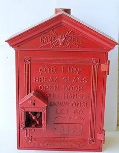

Anyway, the Gamewell box, looking for the little dog house that surrounds the key. Probably impossible to find, in which case I’ll fabricate something that looks like it. Not sure how, but I’ll come up with a suitable surround if I can’t locate the part.

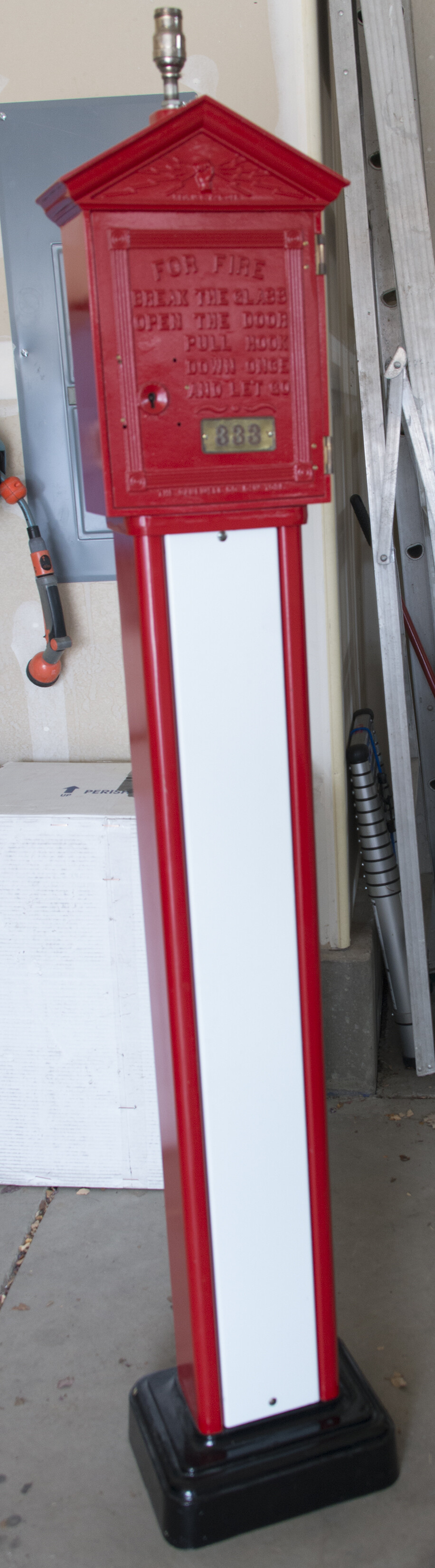

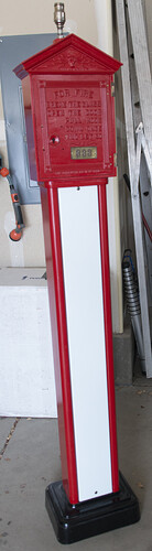

Got into this beast, have most of it detailed out. I can’t decide whether or not to highlight the fist with lightning bolts in white.

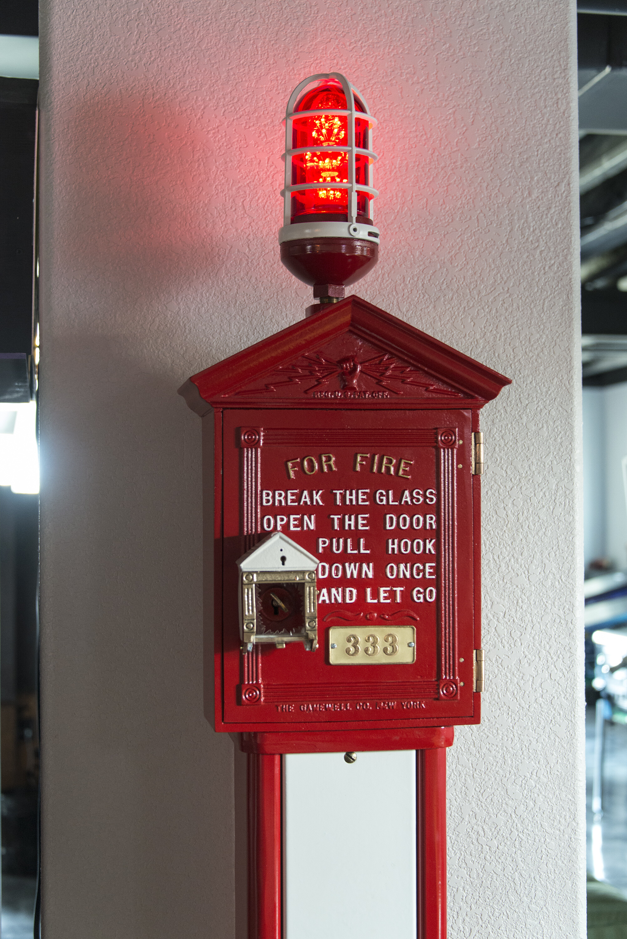

I’m waiting for an OEM cage light and plan to wire it up to blink when the mechanism is running. It’ll blink out the “333” code and double as a night light.
Overall, it is in terrific shape. Looking sweet sitting in my game room.

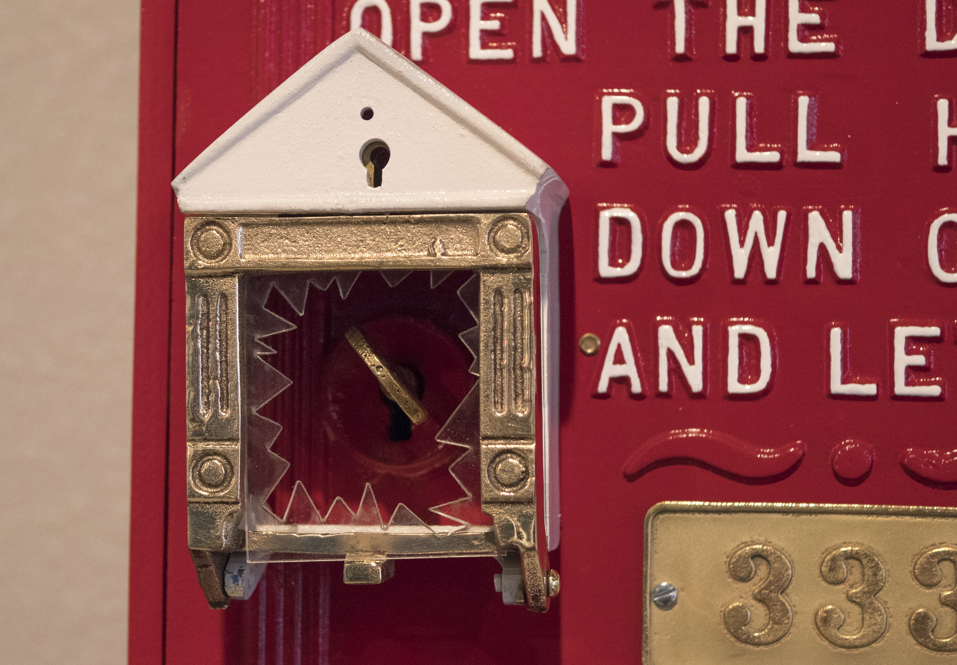

Painted, polished and restored a repro key house and put a laser-cut piece of acrylic in place of the glass that appears to have been broken already. This permits access to the key and still maintains the glass look. Designed to allow your fingers to get to the key without getting impaled by shards of glass - each point is smoothed out.

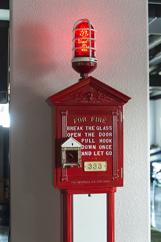

Next, I’m going to install a remote alarm bell that chimes when the signal wheel is in action. I found an original lamp for the top and have it wired to the alarm signal system so it blinks when the clock runs.
