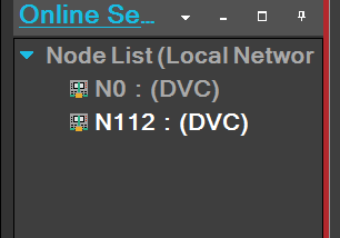

Hey there. I have a notifier DVC running version 8.10. When I connect it to power and verifier tools, the status led flashes green indicating it’s in diagnostic/bootloader mode. And I can’t log into the DVC. Anyone know how to solve it? Posted below is what shows up on the network.
Which revision DVC is this? should be on a sticker on the back.
If you if click in the highlighted node 112 or right click on node 112 does it give you an option to enter a password?
yeah but they always time out
Don’t have it with me rn but pretty sure V8.10 DALV1.05
