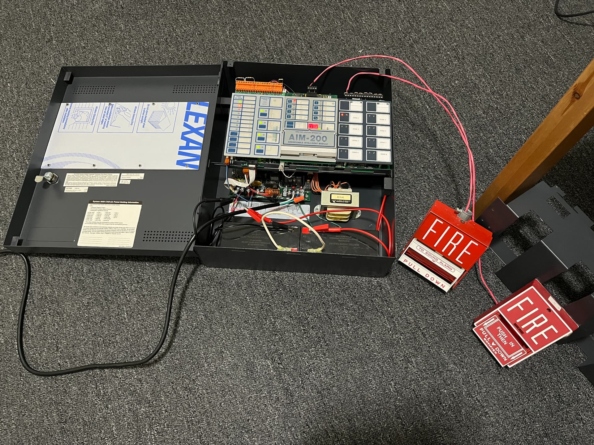

Here’s some pictures of my Notifier System 5000 fire alarm panel. There doesn’t seem to be that much media on this panel, and finding them on eBay is pretty rare. I built this panel from scratch; all of the components from this panel were purchased separately.
As a side note, this System 5000 is in a CAB-AA cabinet, which is the smaller cabinet for this panel. You often see this panel in its larger CAB-3 or CAB-4 cabinets, sometimes accompanied by an AMG or various cards.
The System 5000 is related to the System 500 (used for smaller applications; has limited features compared to the 5000) and the System 2500 (same CPU as the 500 but uses the larger cabinets like the 5000). This panel has an AIM-200, which provides support for addressable devices on the panel. There’s also an IZ-8 zone card, which I plan to replace with a proper IZM-8 some time soon. The power supply board is an MPS-24B, used in smaller cabinets like these. The CAB-AA cabinet was NIB and in excellent condition. Very happy with how this project turned out!

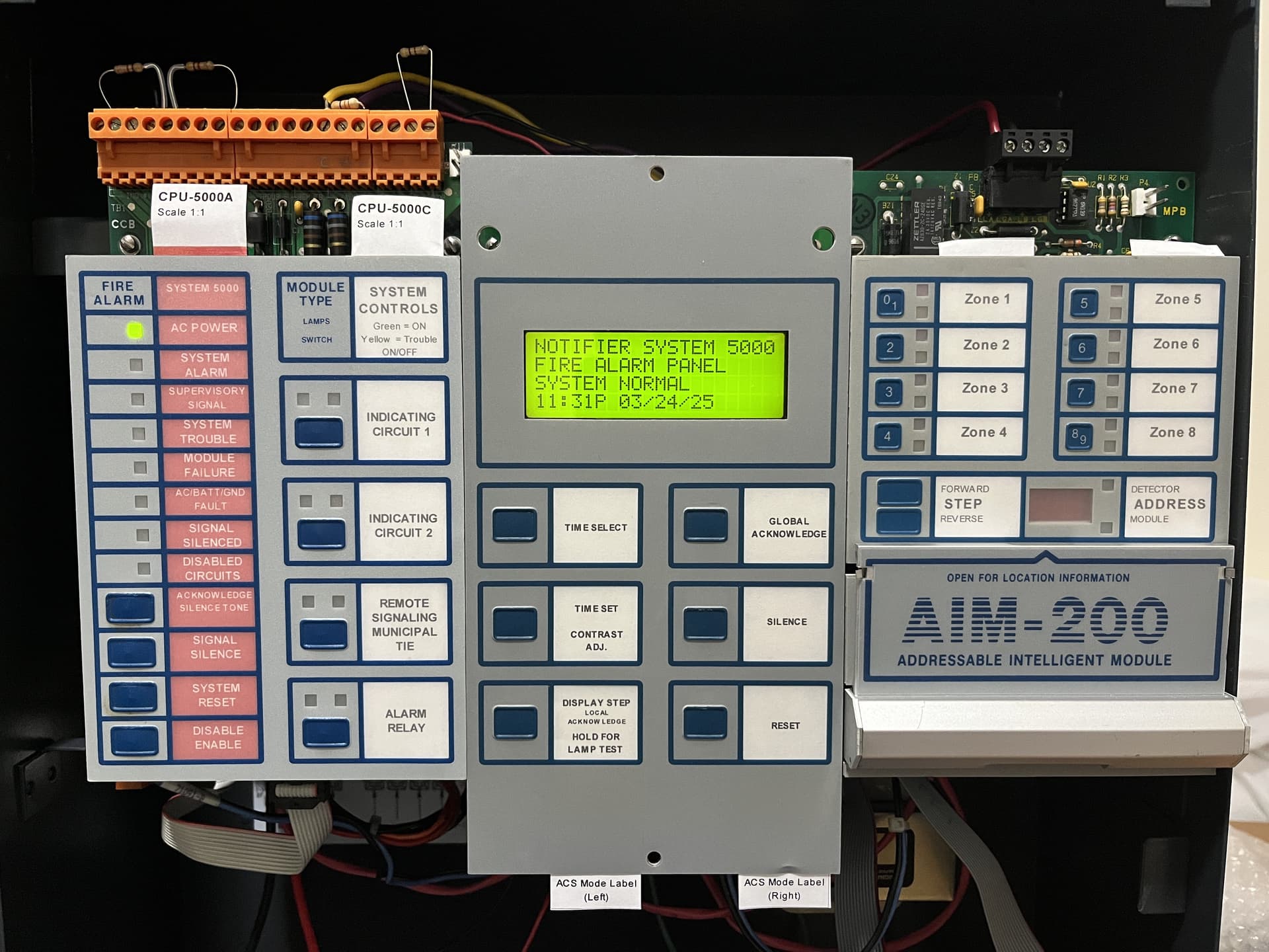

I recently made some fresh labels for my System 5000 and swapped out some parts.

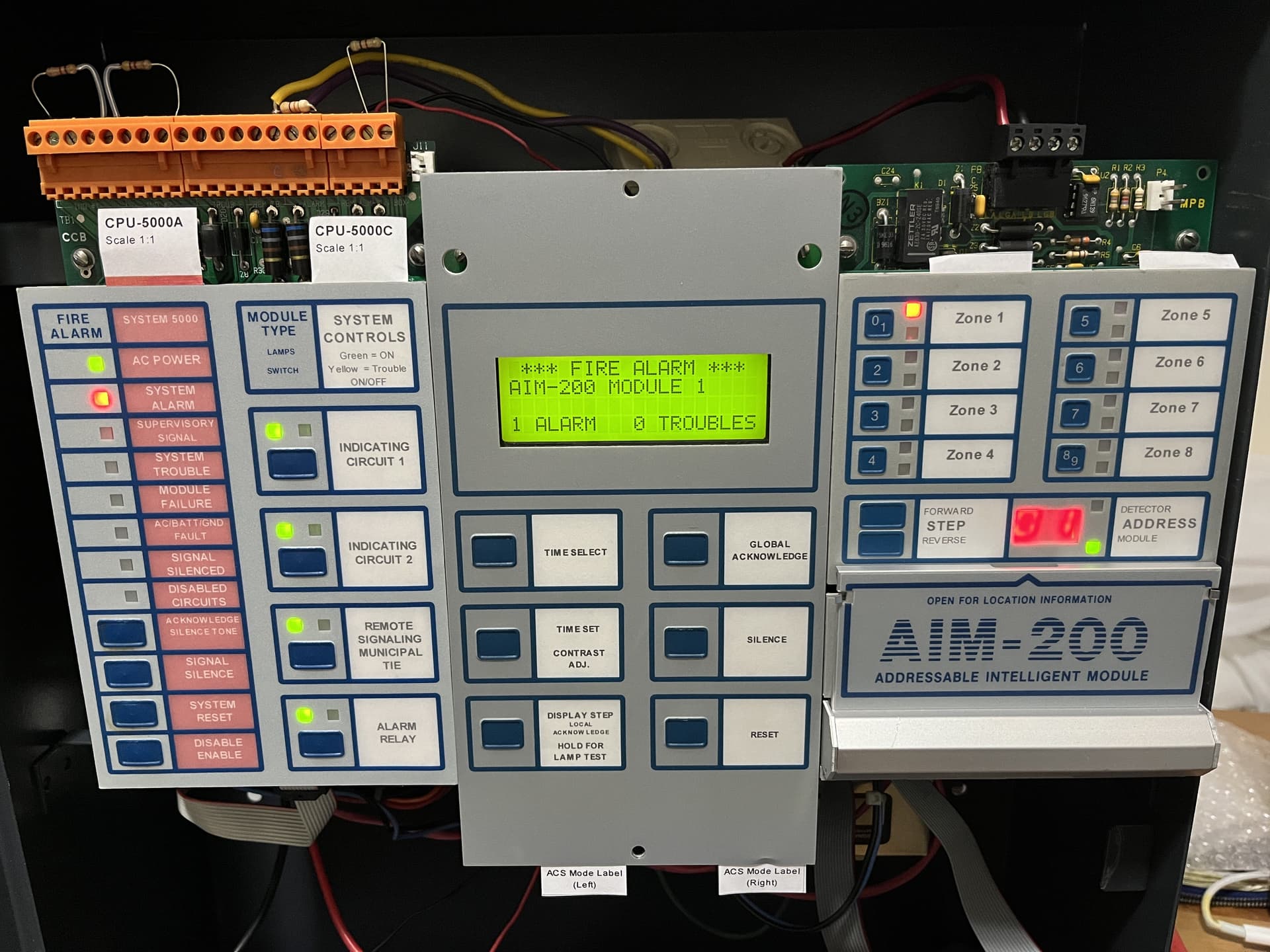

I recently added an LCD-80 to the System 5000. This is a very cool feature for a panel that doesn’t have an LCD display by default. The LCD-80 can also be used on the System 500/2500.
That’s really cool, I would have never known that you could connect an LCD-80 to the System 5000.
I recently programmed the LCD-80 to use custom labels!
The LCD-80 has an RS-232 output that be connected to a printer, CRT, or PC. Using a terminal emulator (i.e. HyperTerminal), you can program the LCD-80’s labels for system conditions and various points.
The LCD-80 is a helpful addition to the System 5000, especially when it has an AIM-200. With up to 198 points per card, you can program the System 5000 annunciate each of the AIM-200’s points (except the last 6 or so, due to space limitations). It’s impressive how many features they were able to add to a panel with such a simple layout!
