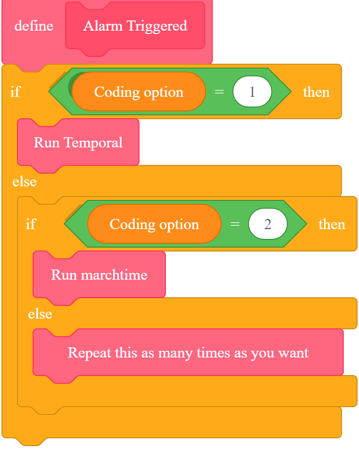

With my experience with Homemade Fire Alarm panels, I can say that the coding options are part of the code, and they are stored on a variable. When the Panel enters an alarm, The Code reads the variable and pulses the NAC to the associated Coding option. For example, If 1 was Temporal and 2 was 120 BPM march time and the panel was set to 1. Then the user changes the coding. The number is now 2. When the panel now goes into alarm, It will run an if statement like this.
I used Block coding to make this as simple as possible.
Since the variable is 2, It will run Marchtime.
