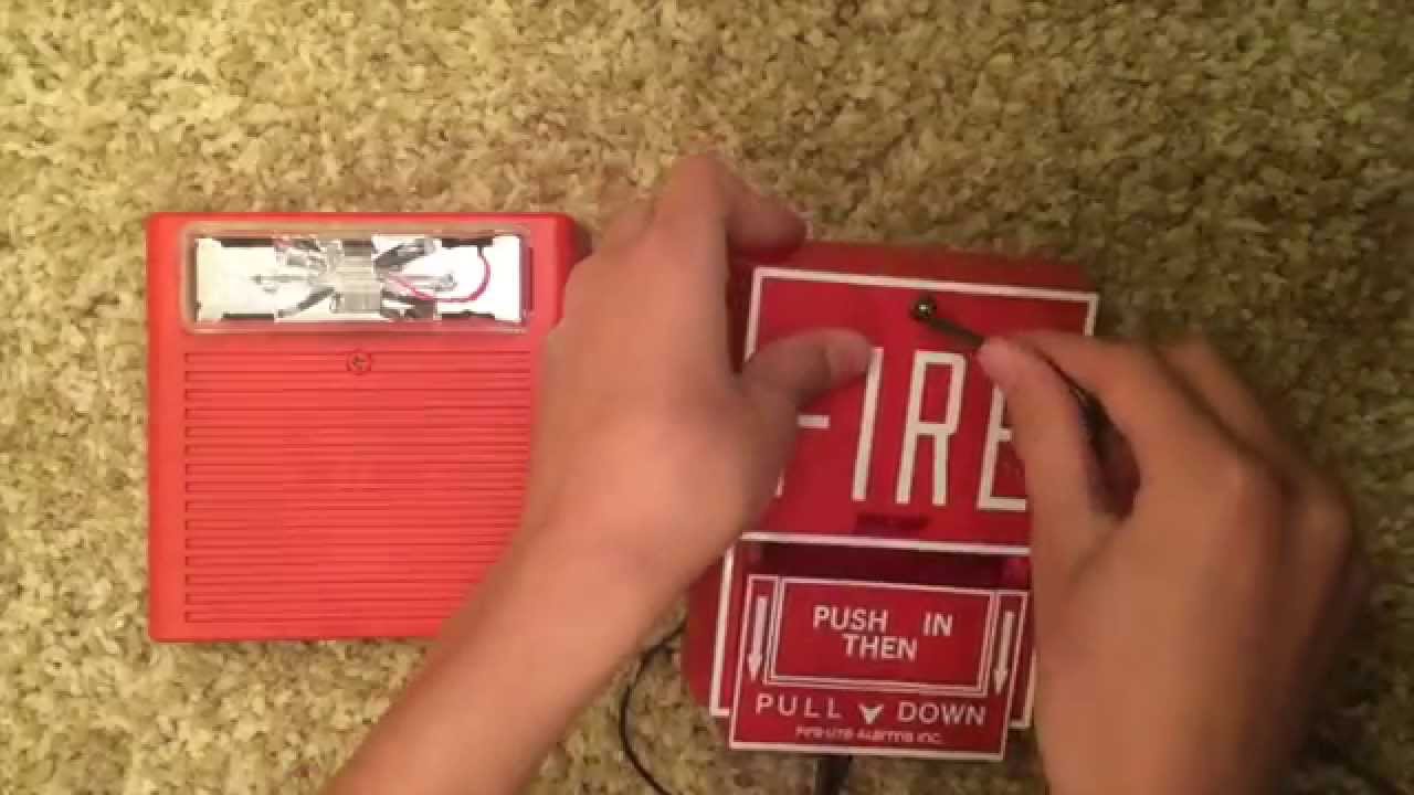

I am trying to wire an EST Genesis speaker/strobe to a pull station. I can’t figure out how to wire it. The back of Genesis has a terminal for Speaker, Common, and S+ And S- 24VDC
The pull station has 2 terminations for Loop In + and 2 termination points for Loop In - With a + and - to switch.
I am not real familiar with fire alarm systems.
Could someone help me please?
This video should help, it’s not mine but it will do for now. hook your power source up to the strobe terminals (S+ and S-) when doing your wiring. Hope I helped you!
If your pull station has terminals marked “loop” it is probably an addressable device and will not work directly with the speaker/strobe without modification. You would need to cut out the module and wire directly onto the pull station switch. Also, the speaker will not emit anything without some type of audio source.
