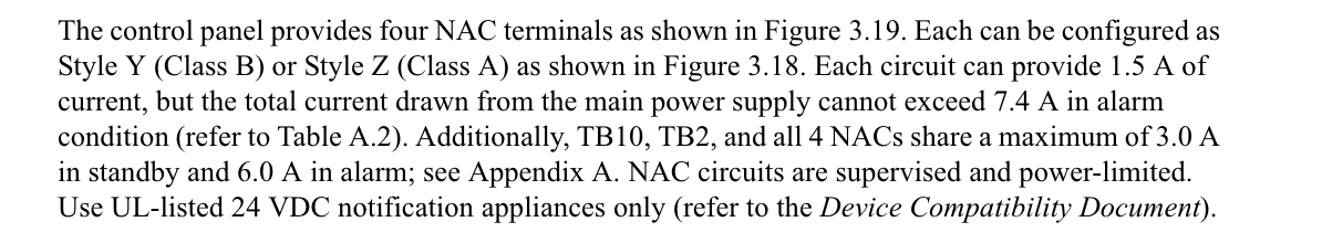

Question about Notifier NFS2-640 for maximum current the NACs can handle without an booster/expander panel
I’ve been wondering what the maximum built-in NAC capacity is.
Because in videos, I usually see a booster panel or the like!

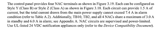

Per the manual…
I imagine larger buildings or systems with older signals would need boosters.
Looks pretty good to me, where it should handle a good amount of horn/strobes.
