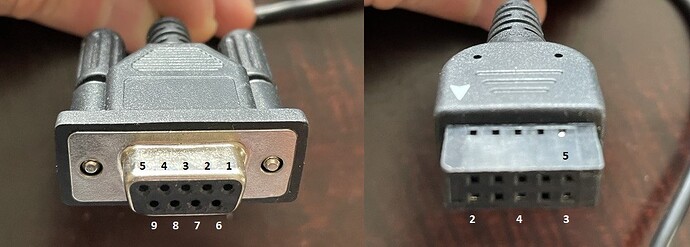

Ok, I downloaded the software, and i’ll order the cable. Question though, what kind of serial cable goes between the simplex cable and the PC? Is it just a straight through serial cable? Null modem cable?
I believe it is just regular serial RS232 but not all pins are used, you need that specific one as the end is an uncommon shape.
d3ab1998b58bbfb7f8a78eebba8060557d4df12f_2_690x247
