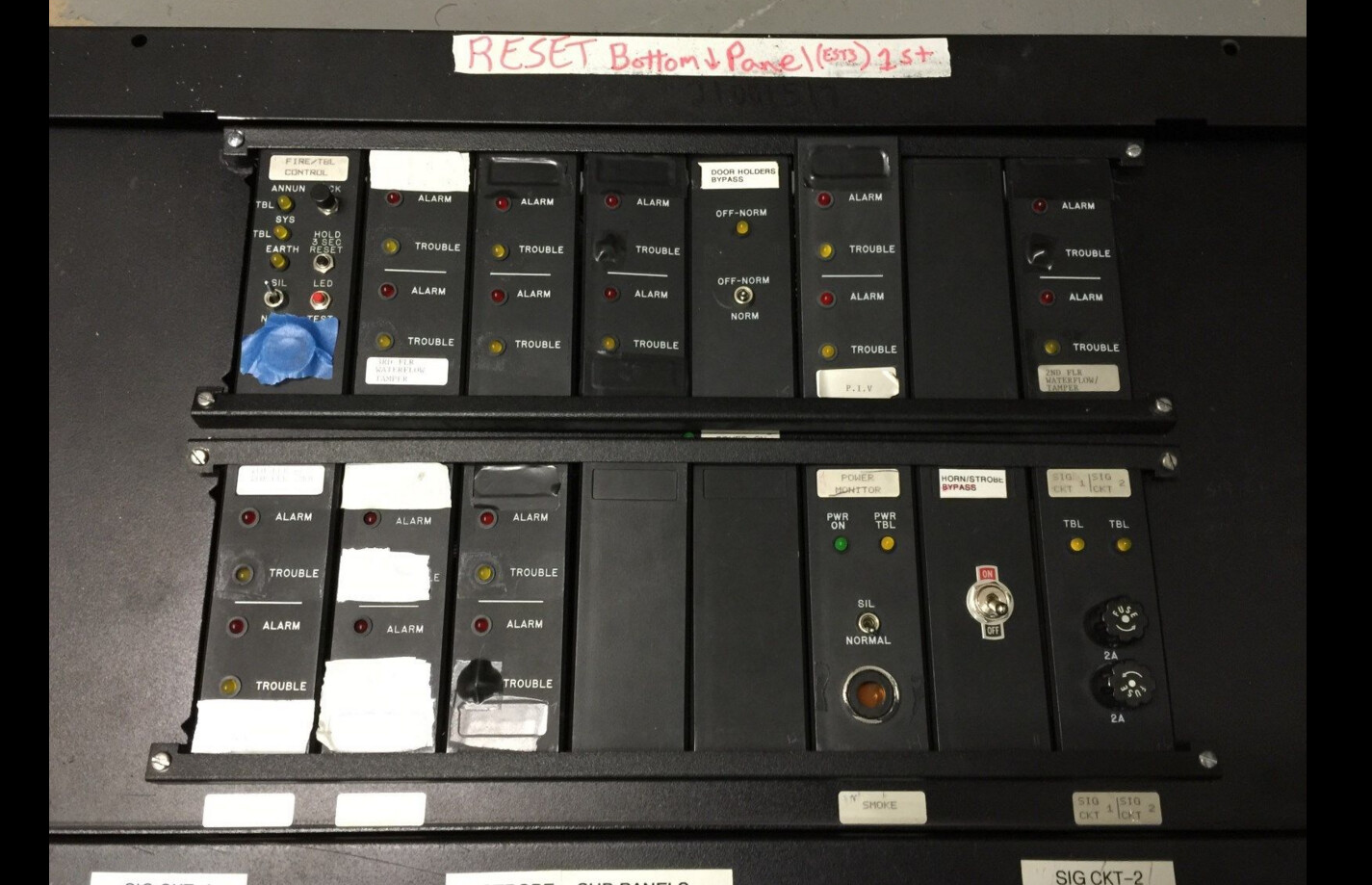

Pictures would be handy so I can what cards are in the panel.
I just took a screenshot from the ebay auction, hope this is good.
I wonder, what is the Simplex part number on that horn/strobe bypass switch!
Not sure, but I will be able to tell you soon :wink:
looks like a CUST-001 module. :wink:
Not to mention the pieces of black electrical tape covering up all those pesky trouble LEDs! “Panel looks ‘normal’ to me!” Lol
And the trouble switch set to “silenced” :lol:
