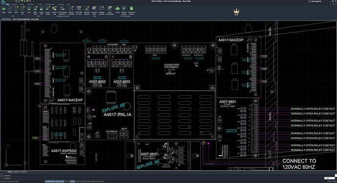

I don’t think any pictures of inside the panel exist yet (mostly because I don’t even think they’re out to distributors yet), but here is a general overview of how the panel looks (component-wise):
Thought there would be since someone posted a picture of one that was normal
Programming wise, even though there is these new nac expander cards, only 1 out of the 3 circuits on it can be used for horns/strobes. The remaining 2 circuits are for speakers only. Also the amp cannot be removed so it only allows a max of 3 expander cards for a total of 4 nac circuits on board for the hybrid + 3 nac circuits max if all slots used.
