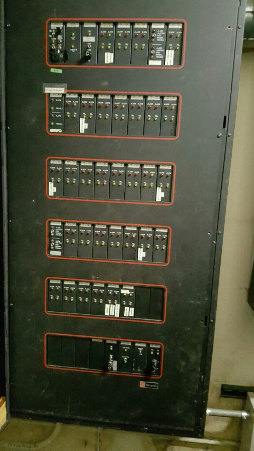

Had a salesperson reach out about the possibility of adding an annunciator to this system. Deal is all of the building is empty with the exception of the 2nd floor. The fire panel, is not on the second floor. The fire marshal is requiring them to have an annunciator on the second floor. I don’t know much about Simplex but I do know, this is OLD. TO me, it seems like it would take an extreme amount of cable (per zone?) and I extremely unsure if we could even get one? I am guessing the picture of the red panel is an annunciator?

The panel is a 2001-8001 and the annunciator is a 4300 series. That panel was last manufactured in 1987 because it was replaced by the original 4100 panel in 1988. That makes it at least 30 years old. I can’t come up with an exact annunciator model number because the 4300 series came in a number of variations. It really doesn’t matter because those are not available any more either.
There was a card that would be installed in the 2001 to drive a second annunciator to keep them both supervised and not overload the zone card annunciator output. It took one card for every 8 zones, and a whole lots of wiring. Of course those have not been made in 30 years either.
You might be able to get an annunciator from Space Age Electronics. They have a line of LED units that could parallel the existing annunciator that might be low enough current draw to not overload the 2001 annunciator outputs. It would require a common wire and one wire for each zone. Then add several wires to operate the trouble signal and reset switch.
Good luck.

A quick glance shows rouhhly 32 zones so youre @ 33 wiree PLUS whatever extra ill need tl operate the switches remotely. Thats all IF we can find something that MIGHT work. To be frank it’s likely just time to move on. The customer doesn’t wanna hear that but it is what it is.
Thanks again!
Ah, count again. I see 35 zone modules in the panel. Each of those is 2 zones, so that makes 70 zones. The annunciator has 64 zones showing in the picture and some of it is not shown.

Get a bid to upgrade the 2001 with a 4100ES. It would take nine 8 zone monitor cards to pick up the zones. The 4100 card takes the same 3.3K EOLR as the 2001 cards so those don’t have to be changed. Abandon the old annunciator and install two LCD annunciators. I only see one two circuit signal module so the SPS would take care of signals. The 2001 used 15K EOLR for signal circuits, the 4100 uses 10K, so two resistors to locate and change. I see one multi-function switch card and two fused reset cards. Add an eight point relay card to replace what they are doing. There is a march time module, software replaces that. There are kits to install 4100 equipment in 2001 boxes so those don’t have to be replaced.
The small box has the only power supply and a battery charger visible. The SPS replaces those. The only mystery is what is under those blank panels on the smaller box? Is it empty space left for expansion? Or is it a ton of relays doing selective functions? It could be anything. Have to get brave and take a look.
