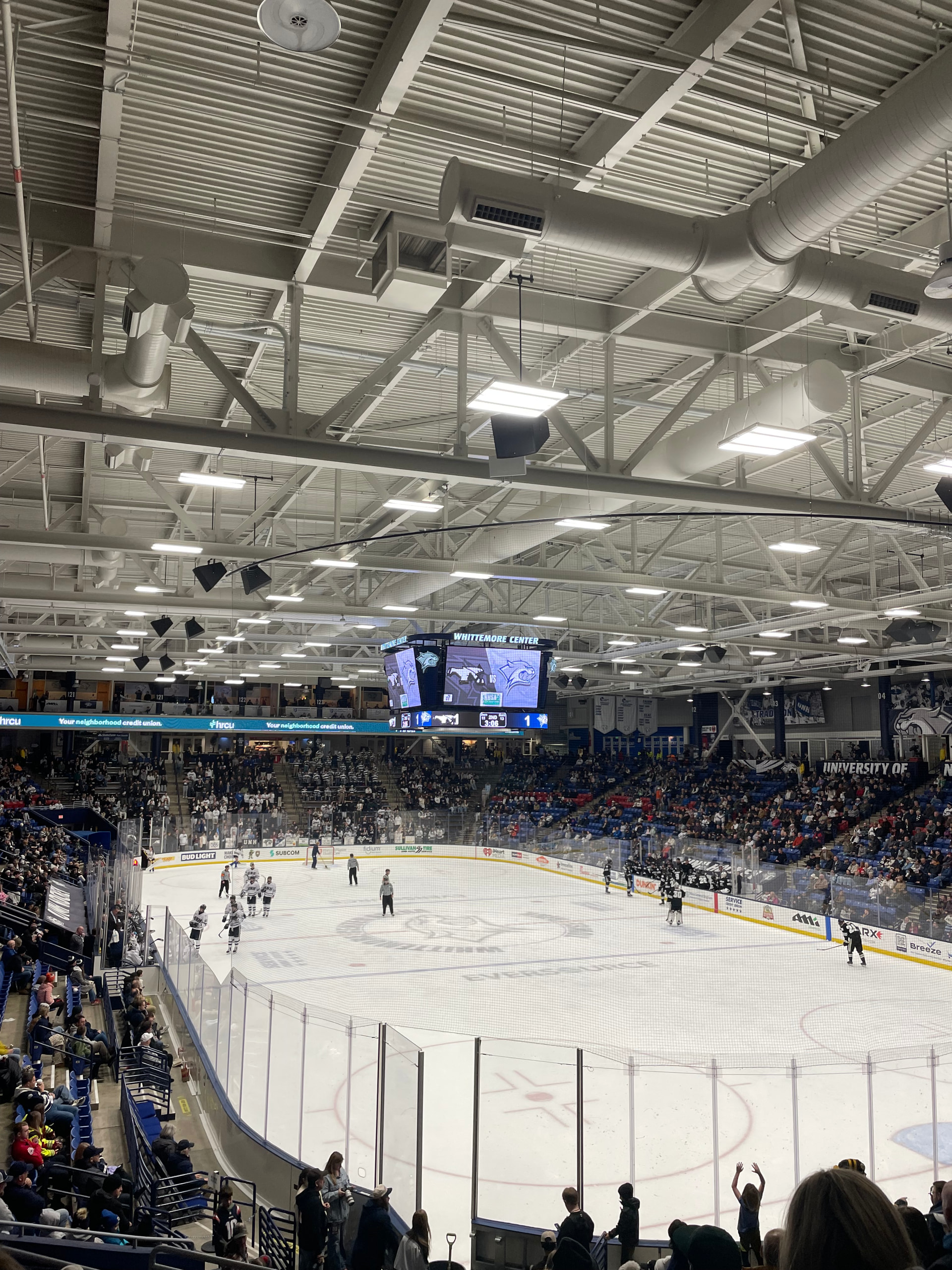

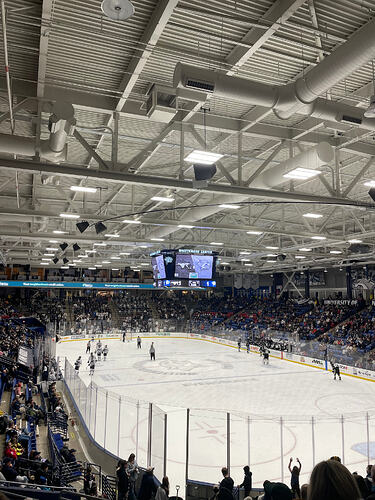

Spot the fire alarms
I can’t find any lol
Large arena occupancies like this generally will route their FA audio (voice evac) through the main space PA speakers for audible notification and have an intertie to permit a “Please evacuate the building” message to show up on the Jumbotron when the FA goes off as well, instead of having strobes in the main space. This “hiding in plain sight" approach to notification is permitted by NFPA 101 12.3.4.3.5 and 12.3.4.3.6.
This is because normal FA speakers aren’t capable of covering arena-sized spaces, and strobes would be useless in such an open space – as a result, the Codes contain provisions that permit existing equipment to be used to provide effective notification. You will find more normal FA devices in spaces like press boxes, concourses, and backrooms though.

Probably on the walls of the seating areas, maybe some up in the ceiling
Nothing on the walls
Ceiling is a possibility but I need glasses lol
i dont know either
There are lots of large black speakers on the ceiling, which probably deliver the audible signal. It looks like some of them are pointed directly at the people on the field, which doesn’t seem like it would be necessary unless the speaker was for emergency communication. There are also several screens throughout the space that will probably display a message upon fire alarm activation.
