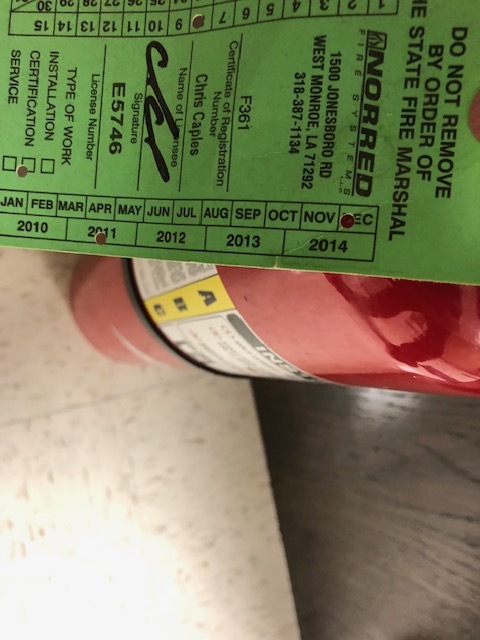

  1. The lights are going out on the second floor. some rooms are completely dark.
  2. The lights in the exit stairs at the back of the building are off.
  3. There are three different leaks in the ceiling.
  4. I found fire extinguishers that have not been inspected since 2011.
  5. There is emergency lighting that is either misplaced, broken internally, or smashed
  6. Meet the only pull station in the entire building.
  7. Meet the only fire signal in the whole building. Or should I say on the whole OUTSIDE of the building. THIS IS THE ONLY SIGNAL ON THE WHOLE SYSTEM!!!

The fire extinguishers were an oversight on the company’s part.

Update: I contacted my pastor (owner) of the building, and he said that he was well aware of the issues, but he doesn’t have enough help to get some of the smaller problems resolved. He also confirmed that the fire extinguishers were inspected, and the company missed the ones upstairs from 2011.
