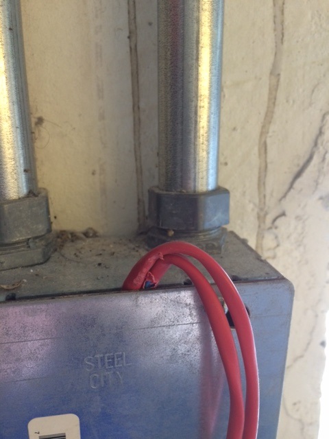

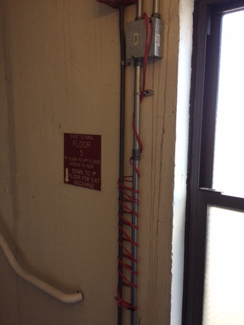

Found this the other day! Mid-rise apartment building - from what I could tell the wiring that is so thoroughly twisted up wasn’t actually connected to anything but went out with the smoke detectors that covered the hallway. So I’m not quite sure what the purpose was supposed to be, but given the nice nick in the jacket from someone either pulling on the wire or tightening down the cover too hard, damaged now!
This… is just ridiculous. :roll:

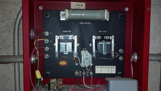

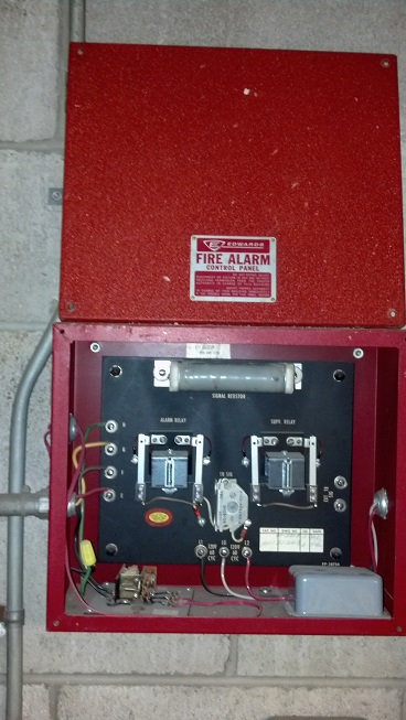

Came across this old Edwards B01-1 fire alarm panel today - dated 1961
No longer in service but rather clean for an 50+ year old fire alarm panel - removed the cover to show the internals.
No controls or indicators on the front of the panel, guessing it was one of those systems where the pull station is activated and as long as it was in alarm the bells ring.
I love those old, simple panels. Been trying to get one forever! XD I know FCI makes some.

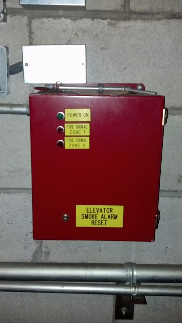

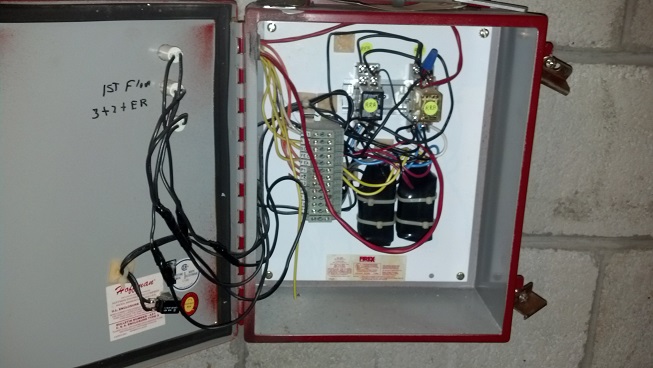

Firex elevator smoke detector panel in the same building - this one was still in service!
Here you have 120V smoke alarms located in the elevator lobbies, connected back to this control panel for elevator recall purposes. Don’t see too many of these around anymore!
Seen that before. Late 80s condo apartment house with 8 units, 4 per floor. At the time was not required to have a fire alarm system so they’re using 120V smoke alarms to recall the elevator. Machine room had a similar panel to this one that was also homemade looking.
An identical one was built right next to this building at the same time but it burned to the ground in 2007. No deaths. Was rebuilt 2008 and has an addressable Siemens system.
I think a few of the elementary schools in my city had these in service up until 2004, when they replaced basically every old system.

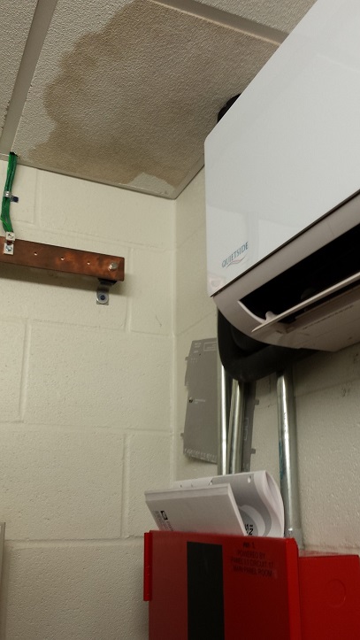

Got called out to see why a power supply was in trouble, and I found this:
Hmm. Wonder what happened.
This box still had live 120v power and proper voltage over the SBUS terminals. But the only LED that power supply has, well, she no blinky! Plus I tried manually activating the NACs via the I/O control menu but they didn’t sound either. Supposedly this is like the 3rd set of power supply guts in this thing, and the building is brand new. Not the first system I’ve worked on with water issues either. Anyway, good times.
I remember when a leaky ceiling took out the Faraday MPC-2000 fire alarm panel at my college’s Field House building in the summer of 2010. SO, what they did was put the new panel right in the main lobby, a Fire-Lite MS-9600UDLS with a really big junction box next to it, replacing the existing annunciator. Then in the electrical room the old panel was located, the MPC-2000 was gutted, and a Fire-Lite power supply cabinet was plastered to the front of the door.

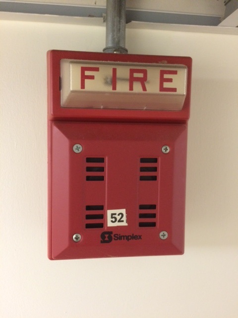

This was what I had to do today… The site I was at had a really bad water leak. Their insurance guy told them that water had got into the strobe lenses of the horn/strobes because they looked “cloudy”. Had nothing to do with the fact they were like 20 years old! So I had to go around and take 7 of these apart and photograph each one to prove to their insurance guy they were fine. At least I get paid by the hour!
