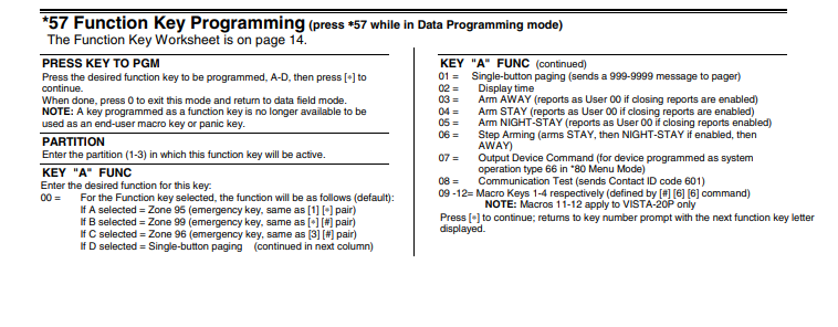

In *57 Programming, there is a 2 digit entry to specify the keys operation.
According to this list. Your keys are programmed for Number 09 to 12, which are Macro keys.
It does not show it on the list, but 00 is the entry for Emergency Keys. (Zones 95,99, and 96)
For A,B, and C keys, try entering *57, Pressing the button you want to program, and enter 00.
For the D key you can program it to what you wish.
Well said. He would still have to program the respective zones in *56 zone programming to use emergency keys.
