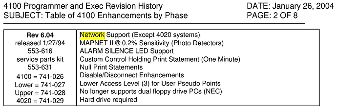

4100 Classics may be added to a 4120 network if they are on REV 6.04 or later.
