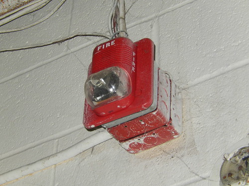

Better question should be “when do you come across systems that are actually done correctly?” There is so much sloppy work out there it’s scary. I know I’ve posted some pretty sketchy work I’ve come across on here. Look back at some of my previous posts and you’ll see. Yesterday, I saw this fine example of workmanship. How anyone installs this, steps back and looks at it, and is PROUD of their job, is beyond me.
That’s a pretty bad job. It looks like it could be possible to just flush mount that device (as long as there is a back box in the wall)?
Looks like somebody was trying to use up their old stock of BG-10 back boxes.
That only happens on a Friday at quitting time.
Actually, the other pulls in the building were BG-10’s. So probably a replacement for a broken one. They just didn’t bother to switch out the back box.

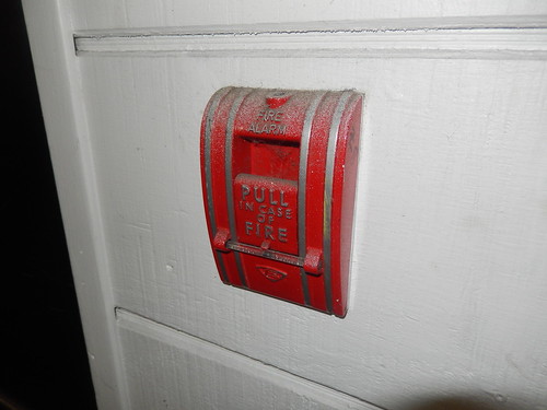

Next up we’ve got an Edwards 270-SPO, which isn’t really all that bad other than a bit of paint.

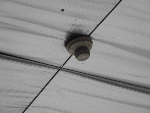

Now we get to the ice rink smokes. The ceiling is very high up off of the ground, and there are ionization smokes, such as this 1400. You could have a bonfire and that thing probably wouldn’t activate.

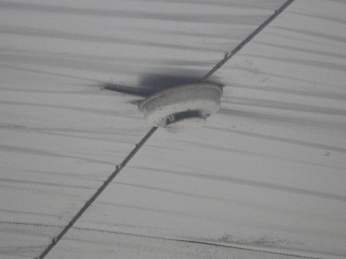

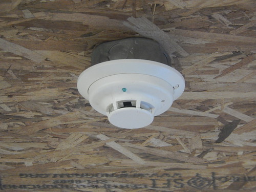

Here’s a smoke that’s in decent condition.
DSCN7791 | 4j25Sirens | Flickr

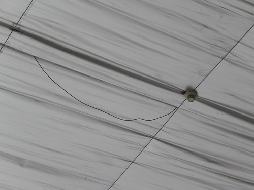

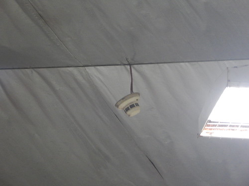

Oh boy. Exposed FPL and that 2400 isn’t even on its base. Can it get any worse than that?
DSCN7793 | 4j25Sirens | Flickr

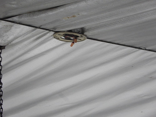

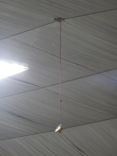

Of course it can. Check out this low hanging 1400.
DSCN7788 | 4j25Sirens | Flickr

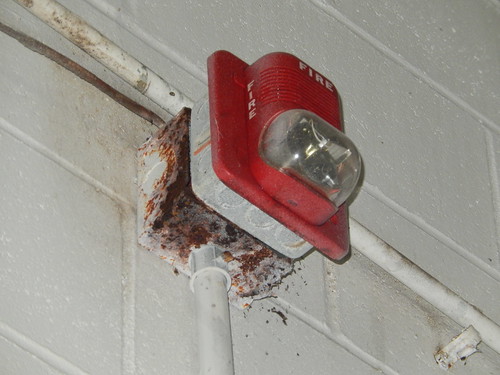

Everything here checks out other than the corroded backbox.

More exposed FPL and shabby looking detectors.

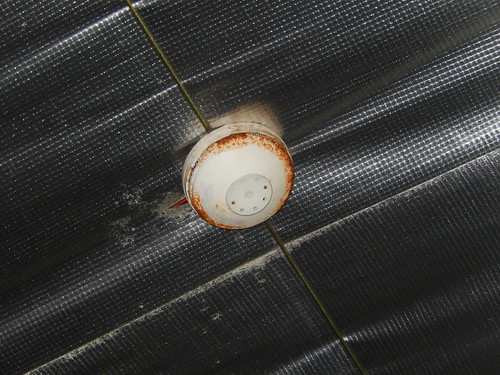

Here’s a rusty heat detector.
DSCN7776 | 4j25Sirens | Flickr

That’s a new feature - smoke detectors that are on a winch that you can lower to make cleaning easy! Awaiting UL approval.
Maybe they got paid by the backbox? I would imagine whatever was there before probably had a big back end. Add the 14 gauge wiring (who knows how many conductors are in that conduit) and those boxes fill up rather quickly. Great places for ground faults!
But in all seriousness, that is definitely a system that has not been maintained. I wonder if the thing is even powered up! I also noticed the smoke detectors lack back boxes. The older systems or the ones that were installed on the fly seem to be the ones where they got away with that. The exposed wiring isn’t really a big deal, other than it’s lacking appropriate supports to keep it in place. You want to protect it in conduit up to a certain height or in areas subject to mechanical damage, but the ceiling on an ice rink is fine. Just look up at any big box store with an open ceiling.

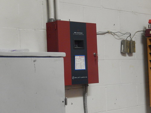

Haha, I just read all the things you said Lambda! You just made my day. As far as “is it powered,” I’m not sure. Here’s the panel, there are no visible lights, but I think the power light is covered at this angle. (Surprised the trouble light isn’t on)
DSCN7810 | 4j25Sirens | Flickr

It was a Radionics panel so yeah. Don’t know if it was for the smoke or something else.
Should be able to see the green LED from straight on. Sometimes a little dim but there. That angle it would be hard to tell.
