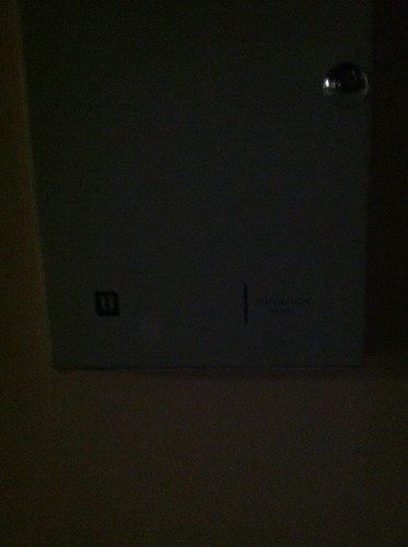

The Honeywell “Distribution Panel”
Arrangement of panels…

It could be that the main panel is located in an electrical or mechanical room that’s off-limits to students. An annunciator cannot function without one. It’s probably a 5820XL or IFP-1000, judging from your school’s size. If you ask me, it’s an IFP-1000, seeing as most new 5820XL installs use SK devices instead of SD devices.
But yeah, lots of panels can support additions to their existing NACs and SLCs, providing the SLC has enough points left. Case in point, my school (built in 2008 with an MXL system) had portables installed last year. In each room, there’s a pull, a smoke, and a ZH. Apparently the MXL had room for twelve more points, since there are three buildings, and two rooms per building.

Then the new panel probably covers all the buildings and the annunciator in the old building is most likely hooked up to it.
