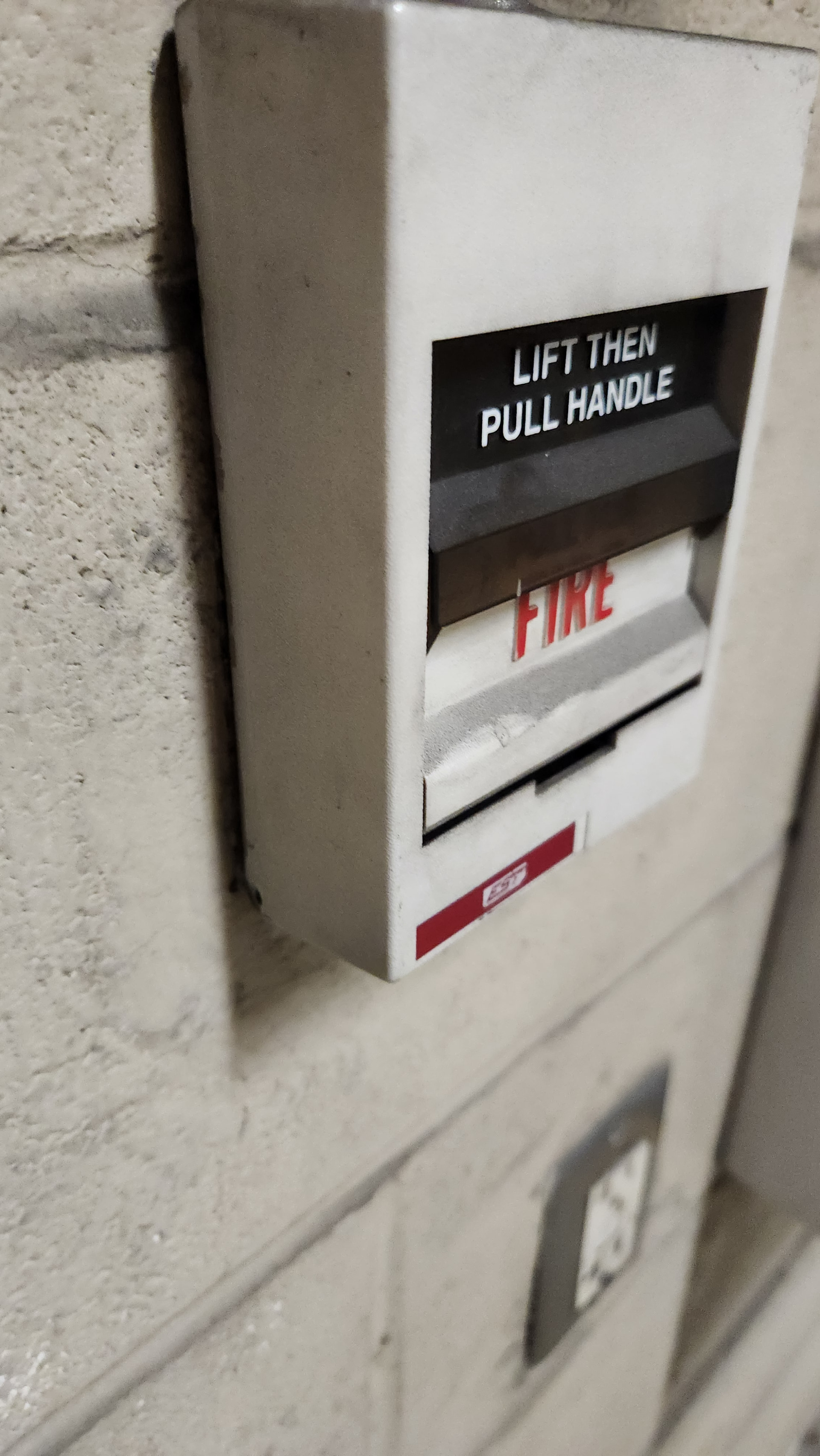

I found this white EST SIGA-278 pull station in a parking garage yesterday. Has Anyone seen these before? There were several throughout the building.
I don’t believe I for one have ever seen any evidence of their existence, so that could just be a custom paint job (though I do know that Edwards has made them in yellow for fire suppression systems). That might actually be against code since last I heard pull stations have to be a contrasting color from the wall they’re mounted to for locatability, & that one isn’t as it blends in well with the white cinderblocks it’s up against. Good find though!
It would make sense if it was just painted since I could not find anything about white siga pulls online. Looks like they did a good job though if it is custom

Although I’ve never seen this variant mentioned in any documentation, I have come across another photo showing an identical white SIGA-278 (perhaps it was from the same building as this one). The fact that the label with the EST logo looks like it’s applied over the white finish leads me to believe that the pull station likely left the factory wearing this colour.
A parking garage is one of the last places where I’d expect to see white pull stations. I can’t imagine that aesthetics are of much concern in this type of installation, so that makes the find even more interesting!
I’m thinking that the installer must’ve had these left over from a different project, and they just reused these here due to the aforementioned unimportance of aesthetics in a parking garage.
Oh yeah, didn’t even think about it being a special order from Edwards rather than an on-site painting job.
Maybe. Still likely violates the bit of NFPA 72 that says pull stations must be a contrasting color to the wall they’re on though.

NFPA 72 (17.17.10.3) and IBC (907.4.2.3) require pull stations to be red, but NFPA 72 allows the pull station to be a different color if the environment precludes the use of red plastic or paint; this requirement isn’t unique to your area. Section 104.2.4 of the IBC allows requirements to be modified when their strict application would be impractical for special reasons, and the inability to use red plastic/paint would likely meet this criterion.
NFPA 72 (17.17.6) does require the background to be a contrasting color, but the effect of that requirement is that the area of a red wall immediately surrounding the pull station must be repainted to a different color (e.g. white) if a pull station is installed.

I just noticed that this is mounted on a white wall, so even if using white pull stations was an acceptable way to make them contrast from the wall, that doesn’t apply here. I doubt the parking garage environment prohibits the use of red materials, since the FIRE lettering and EST logo are both red.
