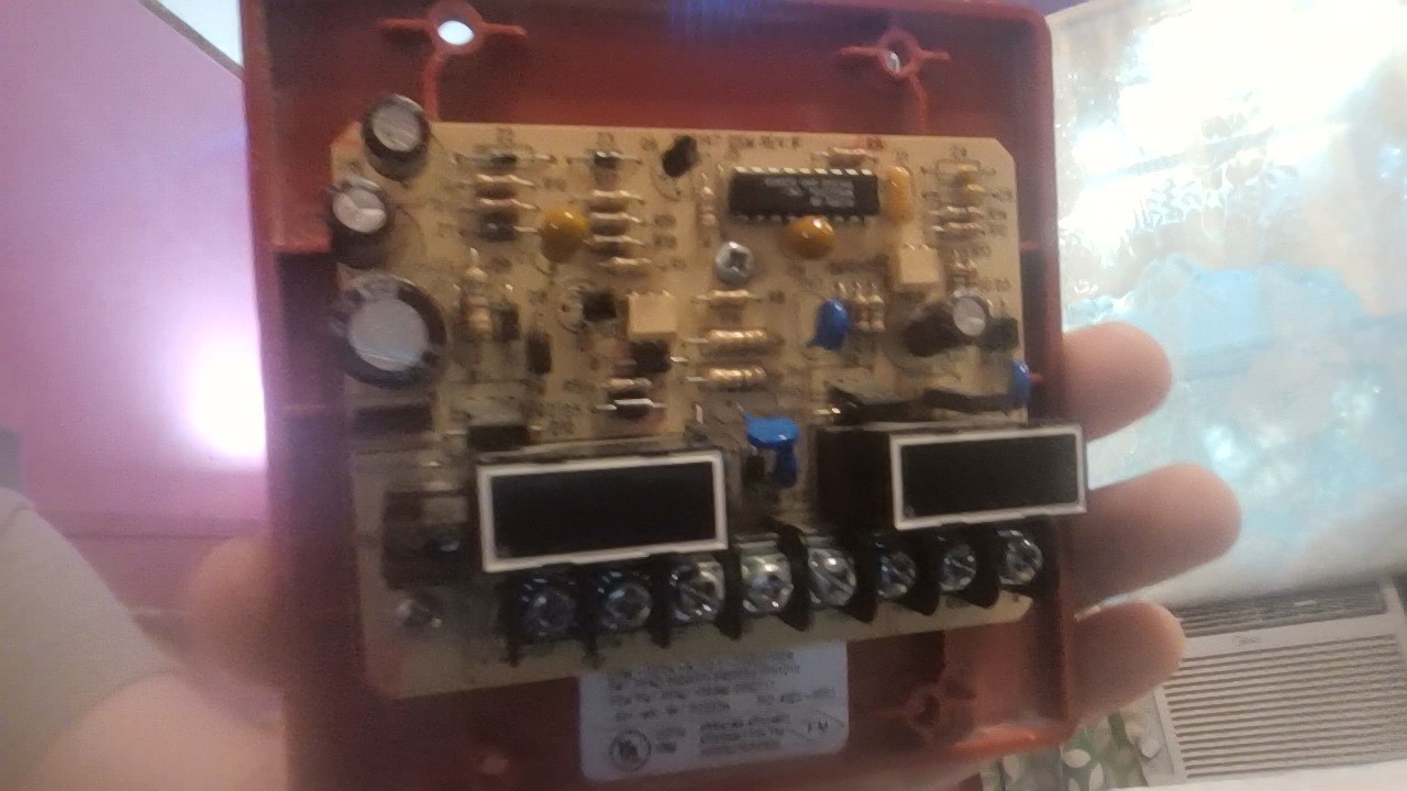

why won’t my wheelock dsm do audible silence

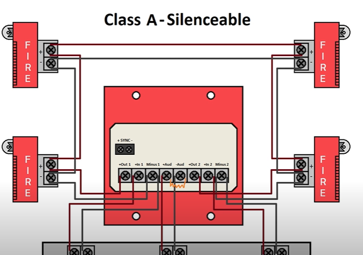

I see some differences in the wiring from this datasheet.
well see i never knew none of that and its all youtube fault for not makeing a video on this one
an because of youtube i done cut jumpers and not its ruined
aand i payed 20 or 30 dolls on ebay for that
What jumpers? It is possible to solder them back together if they’re jumber wires.
no i done tryed but its fine i got another but its the singel relay with 2 outputs
First off, what jumpers did you cut? I don’t remember jumpers at all.
I installed a bunch of these in a factory before, except Eaton branded. You need 3 dedicated signal circuits for audible silence. 2 of them have to be set to strobe or unsilencable signal circuit in order for it to work still and give you the audible silence.
