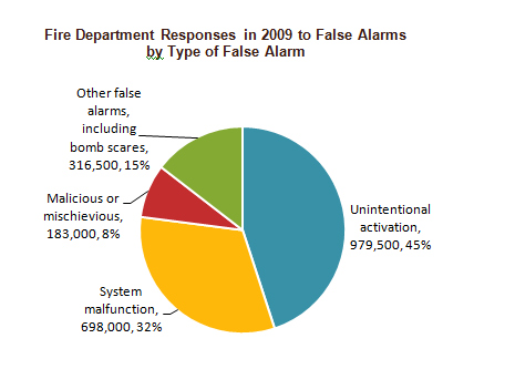

That being said, false alarms often end up to be a waste of time and can cause a large amount of confusion. According to an NFPA Report back in 2009, there were approximately 2 million false fire alarm activations that local fire brigades have responded to. One of these this year has contributed to the unfortunate fatalities of the victims. I believe that this shooting would be considered under the Malicious activity.

It would also be practical to start using a two-stage system along with the voice evacuation. As I mentioned, there are many instances where false alarms are an issue. It has been proven that false alarms were reduced with these types of system. This together could have reduced the confusion and chaos that occured in the recent shooting and any future warnings that occur.
