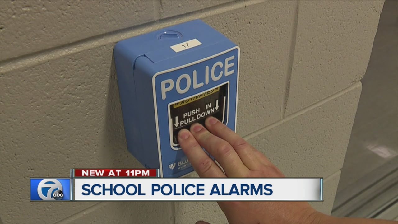

This video recommends that all schools install police alarms in addition to the fire alarms that they already have. People are responding “well, this will lead to prank lockdowns. You know how kids do fire alarm pranks? They’ll be pulling the police pull as a prank.” and “well, what’s next? paramedic alarms?”
Now I don’t know exactly how these systems are put in, but if there were shot detectors as an automatic zone instead of a pull station, that would be pretty cool. However it could be a bit finnicky if not calibrated correctly. Maybe somebody clapping or yelling could set a shot detector off. But if somebody could make shot detection more reliable, then I think that they could become the smoke detector of a lockdown system. Also, I seriously doubt that somebody would pull the alarm. If the students are made aware of the fines and disciplinary consequences that would come with pulling a lockdown alarm, they would probably shy away from it. Personally I’ve never had a person pull a fire alarm on purpose at my school, so I may be a bit biased.
BluePoint also has a medic alarm.

I saw on the youtube comments where someone said that calling the device a police alarm is too generic and could lead to people pulling it during fights or other situations that don’t require a lockdown.
My sentiments exactly.
Someone said that maybe they should also have paramedic alarms, tornado alarms, flood alarms, bully alarms, and fight alarms.
Like jelimoorr said, they also make medical alarms. I’m just imagining having the row of three pull stations on the wall with FIRE, POLICE and MEDICAL. This also raises another question: Should you pull any combination of pull stations depending on the emergency? Say you see someone get shot, should you pull POLICE and MEDICAL? If someone is accidentally engulfed in flames, should you pull FIRE and MEDICAL? If someone throws a molotov cocktail at the school, should you pull FIRE and POLICE? etc.
