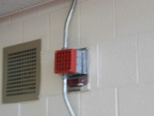

Actually, that’s an OK installation. Just because it looks bad doesn’t mean it is.
Here’s what I bet they did:
When they did an upgrade and wanted to install that pull station, it would be VERY expensive and time consuming to flush mount that station in masonry. Ever tried to cut a single-gang hole in brick? Not fun. Not fun at all. (unless, of course, you’re a mason.)
If you are going to surface mount a device, you need conduit leading to a nearby dedicated power-limited fire alarm junction box.
Only power limited fire alarm cable can be run through these pipes and boxes. (and burglar alarm cable if allowed by the AHJ.)
What’s the perfect place to get to one of those boxes? Why, the horn above. There just needs to be access to the junction box, and that can easily be done by protruding it from the wall, or surface mounting it. It may not look too pretty, but it sure works and makes the AHJ happy.
The reason they put two junction boxes on top of each other is simple- they are not truly “junction boxes”, but rather extension rings. They are meant to extend the depth of a junction box for deep devices, like that 4051. The 4051 is deep. So, they needed two boxes to accommodate that oversized electromagnet on the back, and also to make it easier to run the pipe up.
First of all, you can run whatever you want through conduit. Your just not allowed to run two services together I.E. 110V and low voltage in one conduit.
Secondly, unless your working through a bid or maintenance contract you don’t care how long it takes …in all other instances your billing someone. You bill PER hour PLUS material BOTH of which you make money on. This is the perfect example of a BID job where they rush to get off the job as quickly as possible… HOWEVER no contractor in their right mind is going to be cutting into that wall to install a pull station unless its an absolute must.
And finally, you need two extension boxes to accommodate the fact that one will be only partially protruding through the existing face plate. If you were to only use one extension ring the conduit would not be able to be attached to the box, hence the second extension ring and large bends.
Well, the pull station has always been the same kind since 1974: a Simplex 4251-30 T-bar. At the Oscar F. Raymond elementary school (a rival lookalike school to the Davis K-8 on the north side of town), at that same spot that is at the Davis, the 4051+80 there and the 4251-30 are installed the way they should be. And besides, if they needed to use conduit and junction boxes and the like, they could’ve easily just mounted both the 4051+4050-80 on a single large backbox like this:
Like I said, I am not sure if at the Davis K-8 school, that install job has always been like that since 1974, or it occured when they put in the Simplex 2001 (as I said, all they did during this “upgrade” was replace the panel and the annunciator, and they installed 2098-9806 test stations. I think they did it some time in the 1980s. It has to be from the mid-to-late 1980s, because here is a picture of an older-looking Simplex 2001 annunciator:

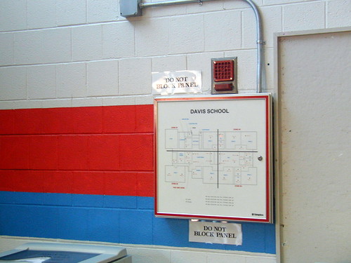

But the annunciator at the Davis K-8 school seems a tad newer than that:
The Raymond school even has this same kind of annunciator, so I guess THEY must’ve upgraded to a Simplex 2001 panel as well! I bet they’ve got the 2098-9806 test stations, too!
