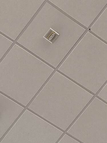

it is completely legal as almost all ceiling devices are dual listed for wall use too. Also because the strobe is designed for the ceiling, it will give enough light around the room anyways.
Is the orientation of the lettering legal? I thought there was a requirement somewhere for the lettering to be oriented in a way that does not require occupants to weirdly twist their heads to read it.
Yeah, the lettering is what made me think of it was a code violation. The strobe should work correctly, but it might be hard for people to know what the alarm is for, especially if the system plays the insane default simplex message. To clarify, the strobe is not a violation, but the lettering might be a problem.
It will be fine. Many buildings with MNS (Mass notification) don’t have lettering on the appliances or have multi use lettering such as this device. This looks to be a voice evac system so letters seems supplementary. also if you here an alarm sound, flashing lights and everyone evacuating you can assume its a fire alarm and tbh the text is not hard to read.
That and the fact that people rarely need to consciously look at the fire alarm to figure out that it’s going off and act accordingly

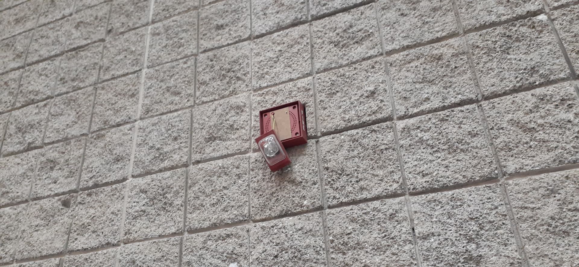

in the second picture you can see and edwards 439d mounted crooked
in the 3rd picture you can see the same bell/strobe with a cage falling off in a basketball gym
and in the 4th picture coming back to the same device in picture 2 you can see the piston that rings the bell is not aligned/ falling off backplate which then would fail to notify occupants in an emergency

Man, that system sure is a mess! Wonder how it got that way (it’s a unique one just the same though given the bell/strobes).
Looks like some kind of poster to me. That pull station looks way too curved to be a 270-series one though: are you sure that’s what it is?
Someone didn’t bring their level with them that day! (even though even hand-straightening should have been relatively reliable: guess that wasn’t done either!)
Either that or it was mounted crooked by the same installer who installed that crooked bell/strobe.
The term for that component of an electric bell is “hammer”, but you’re right: it’s not underneath the gong like it should be, which means it’ll just move up & down repeatedly without striking the gong & thus not cause the bell to ring like it should.
What a mess…thought about getting the AHJ on it, see if they can do something to have all the problems fixed? (most of which are admittedly minor, but still)
