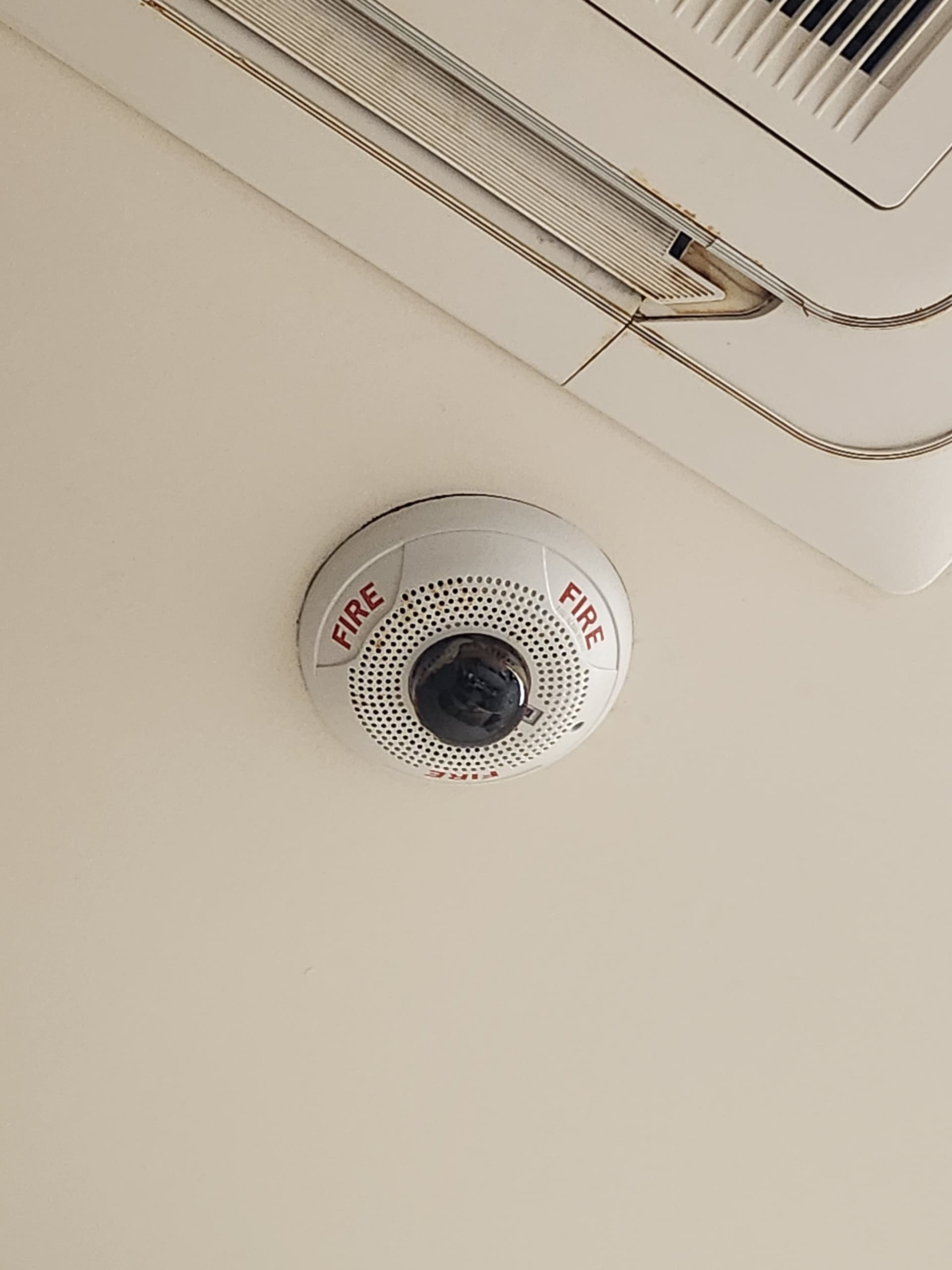

Integrities are rated for use on ceiling and wall I believe. I remember seeing some newer weatherproof ones that were ceiling mounted.
Correct, Integrities are rated for both wall and ceiling. However, the lettering on an Integrity is on a decal that must be manually applied, and there are different decals for wall and ceiling application. Although it’s hard to tell in these photos, it’s possible that the lettering on these strobes is oriented for wall-mounting.
Yea. Though, the devices would still be ADA compliant and therefore not be a fail. If I understand it correctly. It’s why the wall Advance is commonly found on the ceiling.
The wall-mount Advance is still relatively easy to read when ceiling-mounted, since the lettering can be read while looking at the front of the device as opposed to the sides. This is similar to how the original Siemens U-MMT horn strobes had lettering on the sides of the device, which was very difficult to read when ceiling-mounted, but the U-MMT-MCS moved the lettering to the front of the device so that it could be viewed more easily when ceiling-mounted.

Thought this was a security camera from a distance.
It’s a strobe that’s frosted black! But I thought they only did that in white tho.
I say it is because the left head is not pointed towards the floor like it should be
I don’t know about that, the quality is too mediocre to tell.
It looks to me like the strobe blew up! That definitely needs to be replaced.

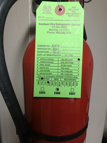

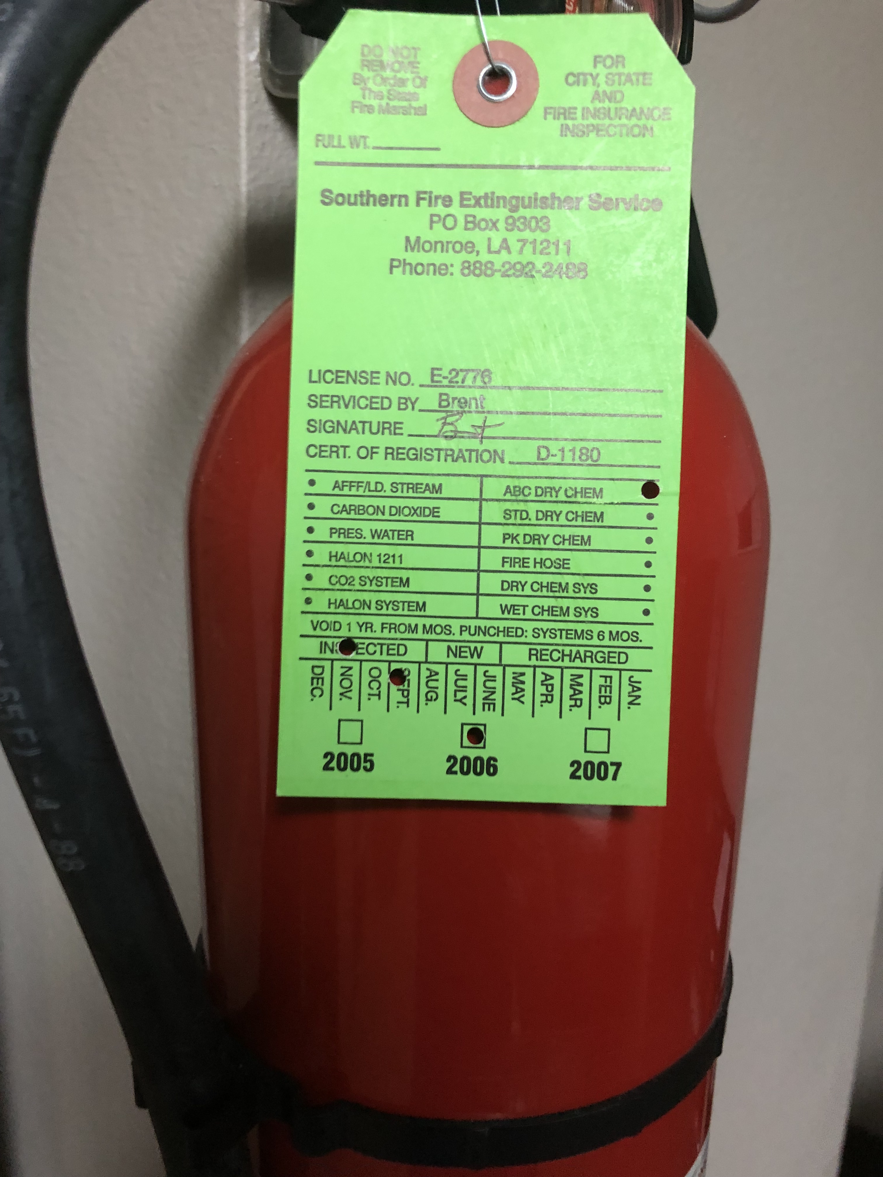

I took this picture today…
NINETEEN YEARS!!! THAT’S A RECORD!!!
