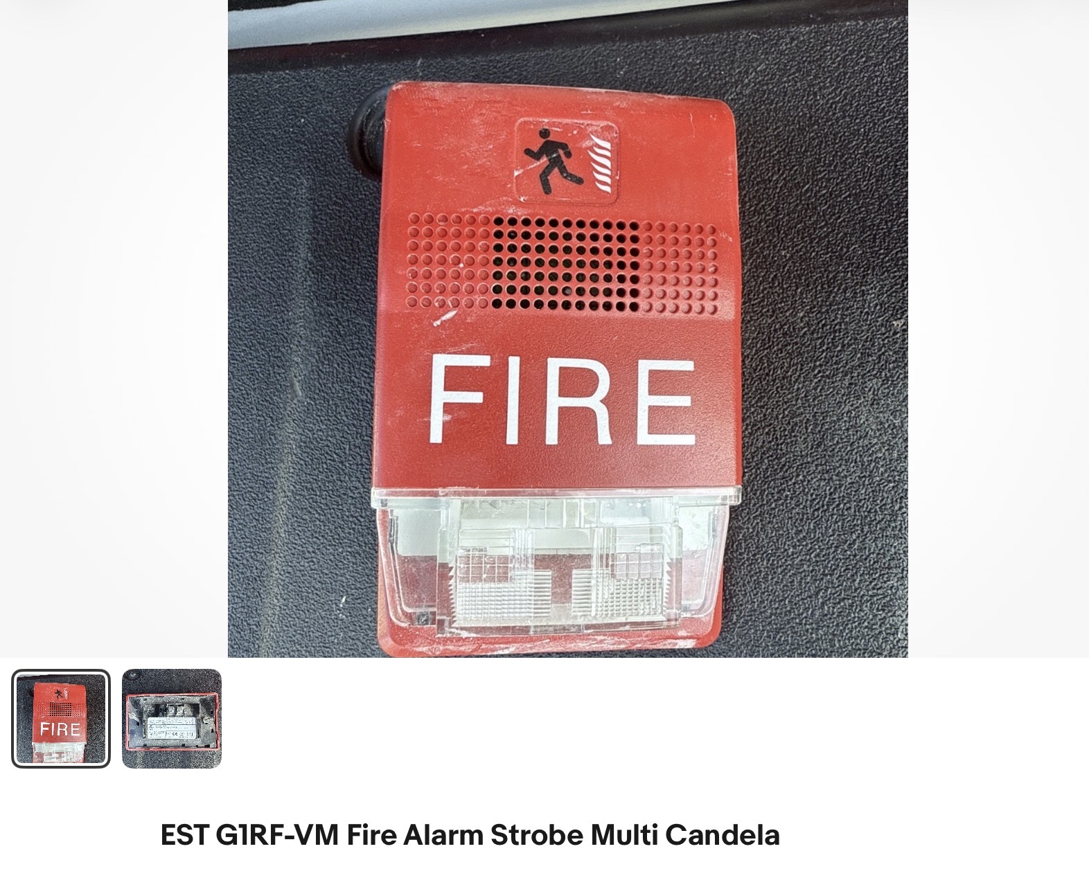

Is this a horn strobe model? I’m a bit worried if this is a remote-strobe model, as I would like a horn

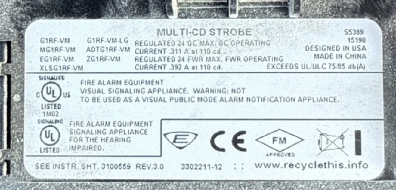

This is a strobe-only model.

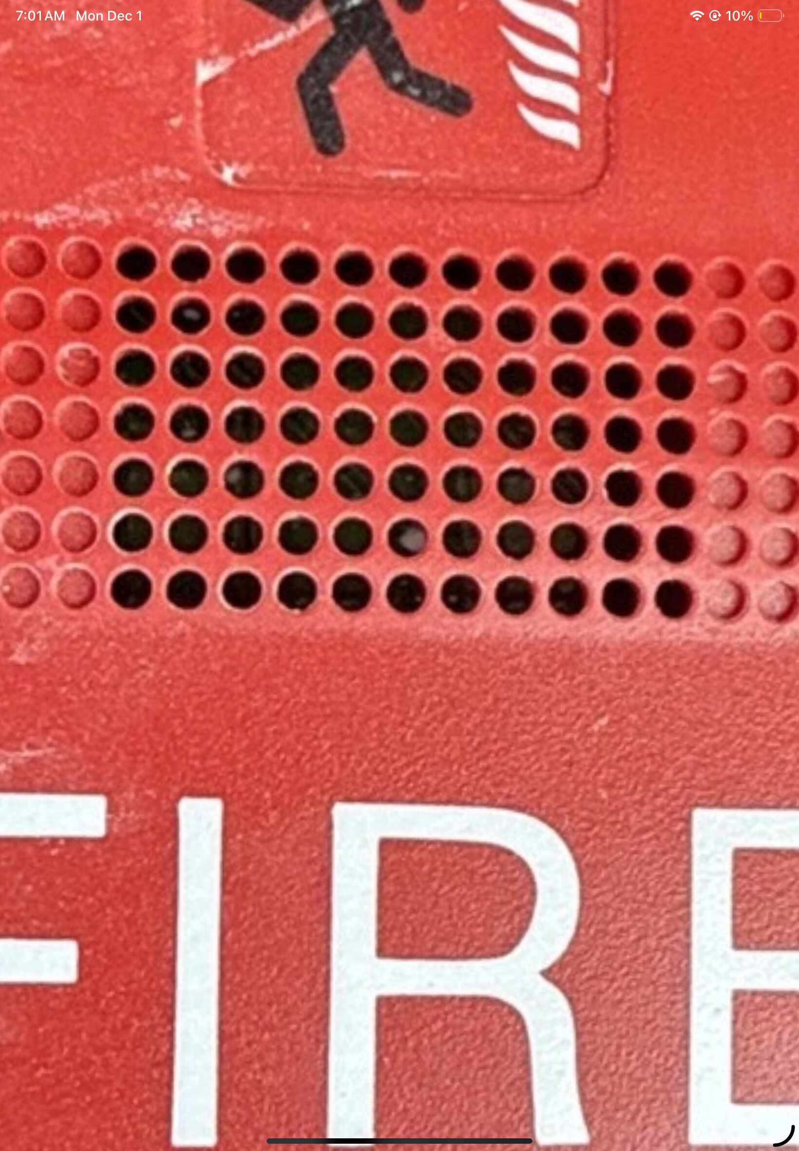

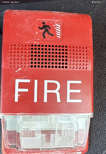

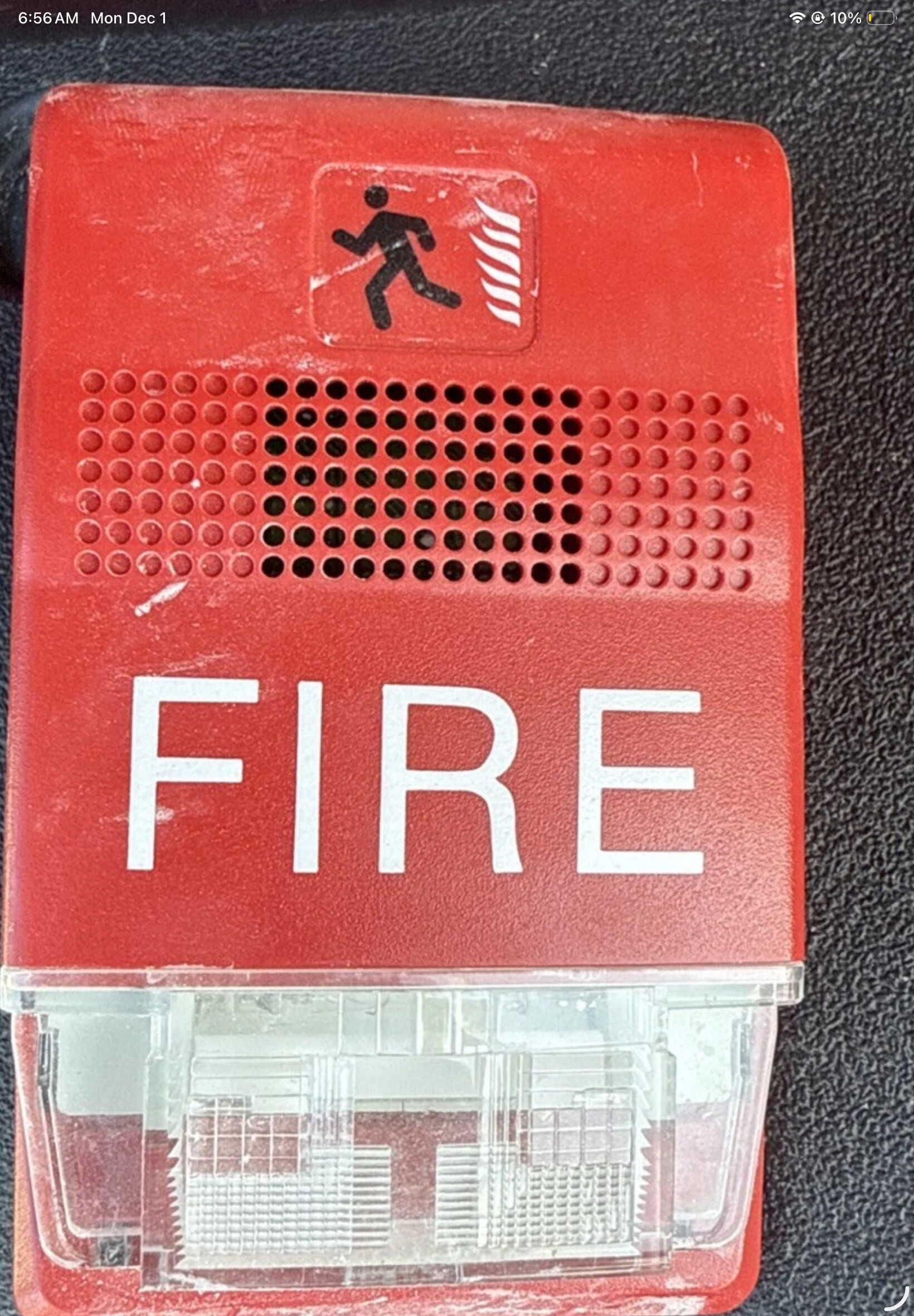

Yeah: xenon Genesis remote strobes look identical to horn/strobes from the outside, but have no horn in them (no idea why Edwards used the same cover design on both kinds of models but yeah).
They probably manufacture a single cover that can be attached to either the strobe electronics or the horn strobe electronics. They might even use the same cover on remote horns if the strobe filler piece is attached to the electronics. The ceiling-mount strobes are different for historical reasons, as discussed here.
Well in any case it was still rather lazy of Edwards to not bother with a hole-less cover like they did with the Genesis ceiling strobes (the fact that they did with the latter makes it odd that they didn’t for the wall-mount models).
